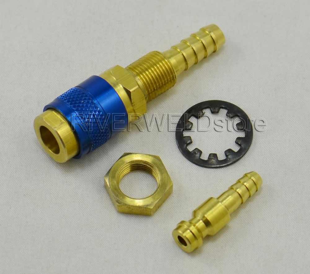

Modded the unit with one of these neat little quick release couplings as below. The tiny little hose is now properly secured with all the correct adaptors and tucked away inside the case.
