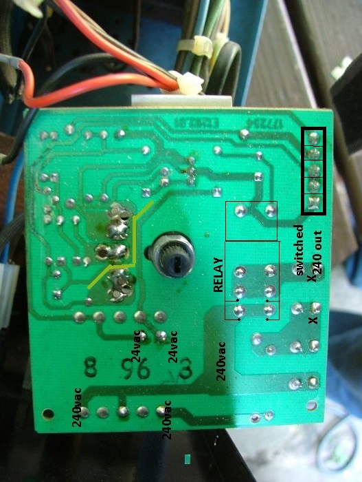

My 135 was working fine until it stopped feeding, initially I thought it was the gun. Stripped and cleaned contact spring and block seemed to resolve. On the next welding run it died again, initially I thought it might have been duty cycle but after leaving there was still no joy.

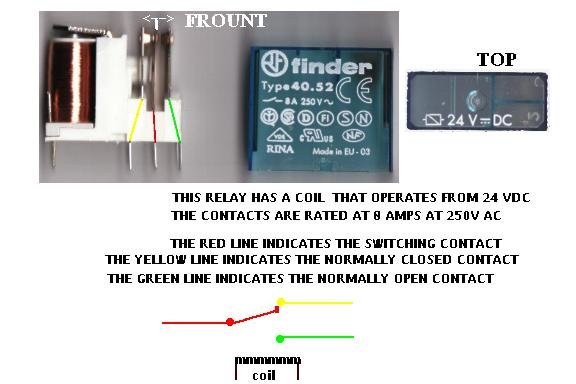

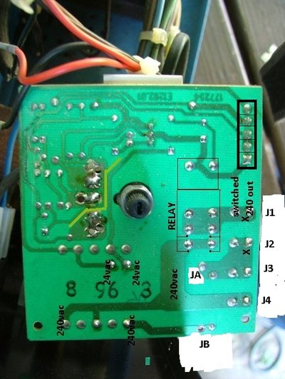

Cover off and PCB inspection, all tracks look fine, relay does not click when trigger pulled though. So my question is, with the PCB out can I test if it the relay or not and if it is can someone recommend a suitable stockist?
Thanks
