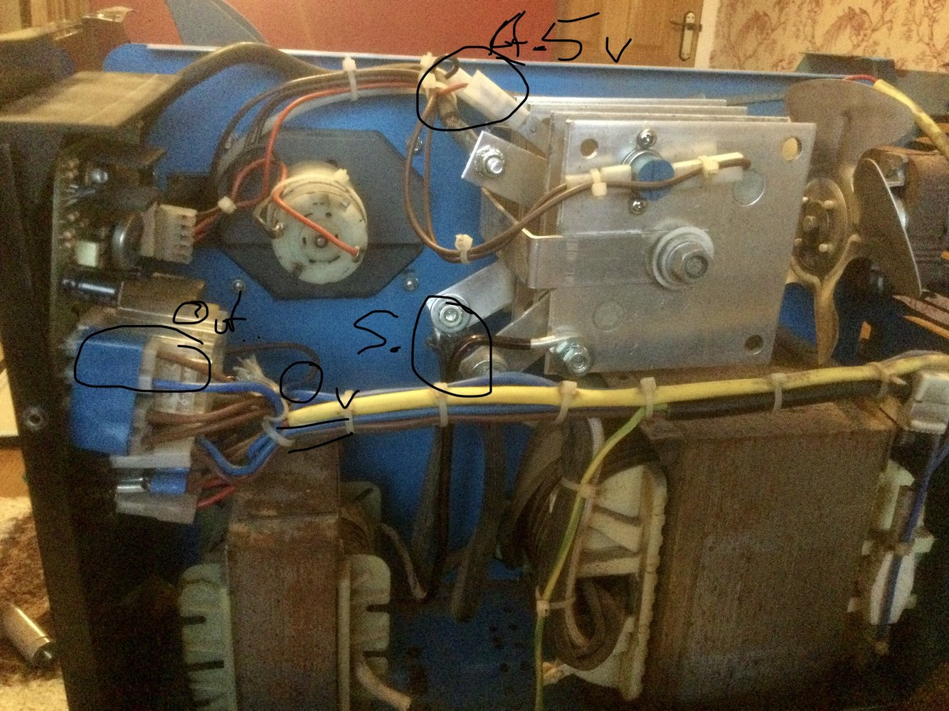

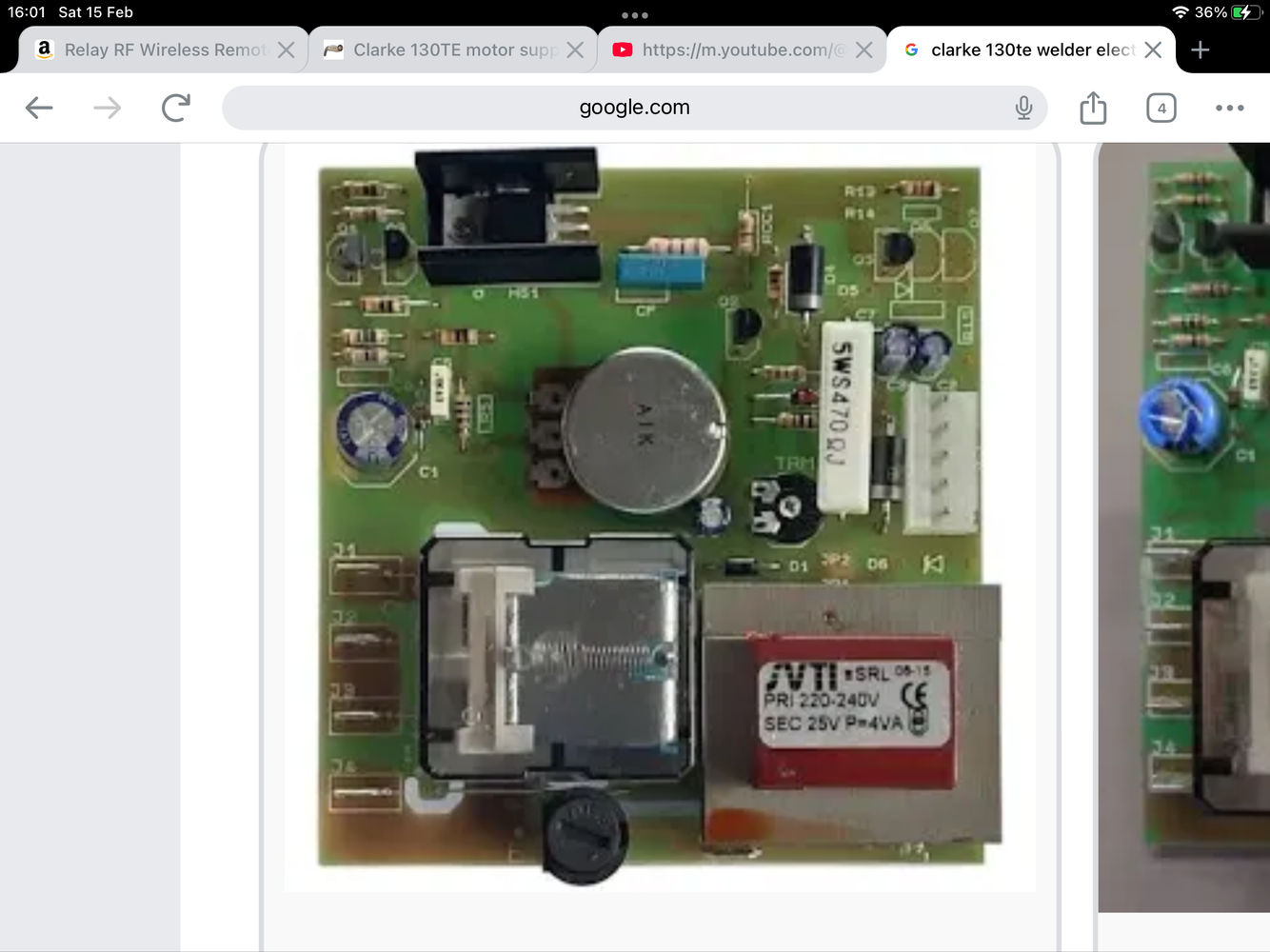

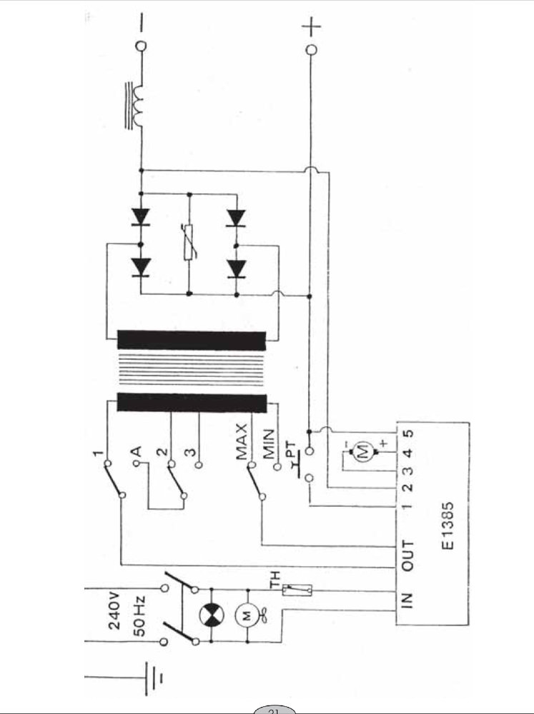

I have an older Clarke 130TE which has lasted well but today my wire feed started to stutter.
When I press the trigger the relay on the PCB operates and the motor starts to move as the relay makes contact, but stops immediately. If I turn up the power ie put the buttons from 1 to 2 and then 2 to 3, the motor starts to try harder (go faster for that one rotation). When the fault was intermediate it would stutter then run ok for a weld. I have taken the PCB off and cleaned the contacts of the relay, taken all the switches out and tested the continuity and they are ok, I have bypassed the trigger switch and no change there are no signs of burning on the PCB.
Any ideas?
