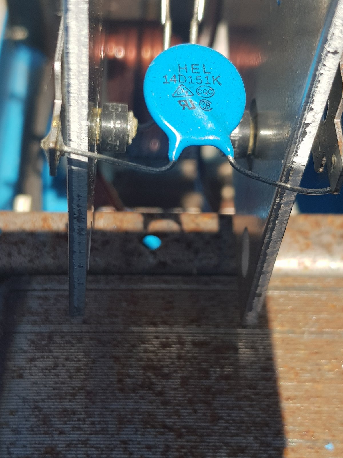

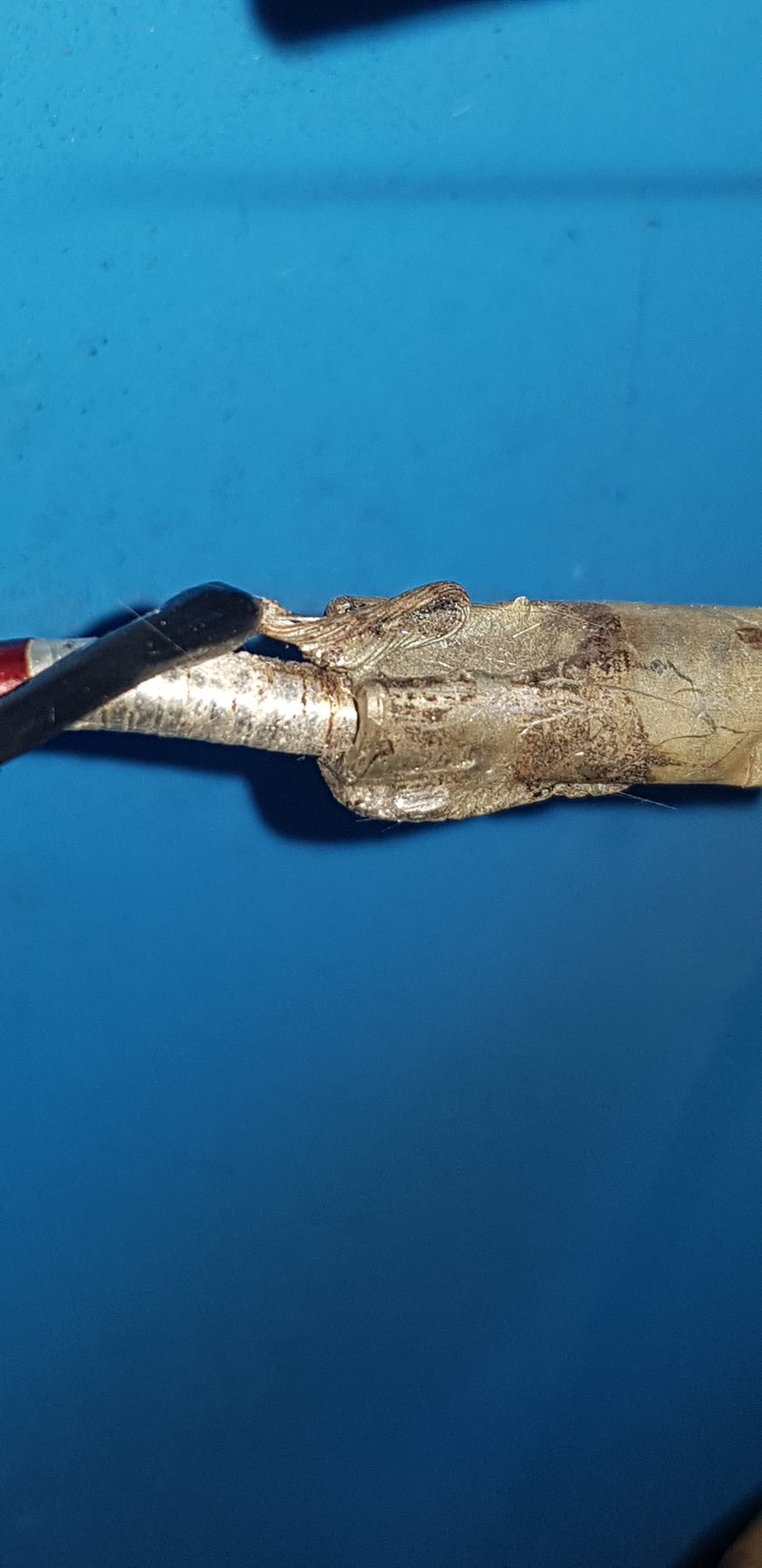

Purchased an old faulty clarke mig welder,

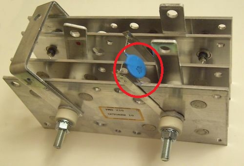

Opened it up located ontop of the rectifier which I believe is an MOV type varistor? It's busted completely [check pic 1], unfortunately the letter stamping has obliterated with it not knowing what one to purchase found a few which might be the match take a look; MOV-07D151K, MOV-10D151K

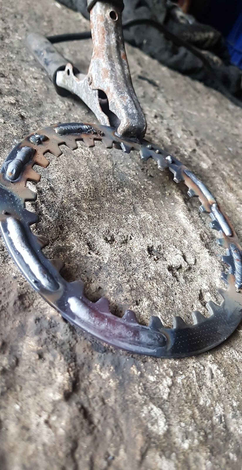

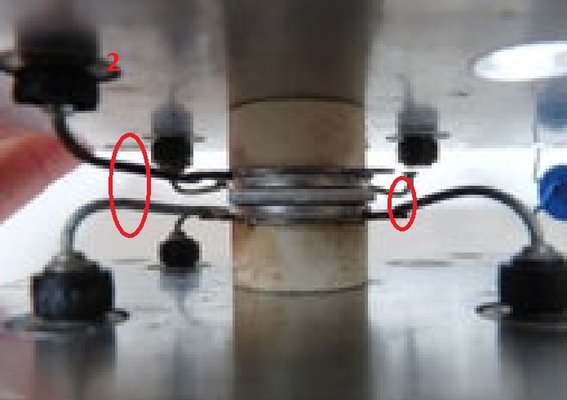

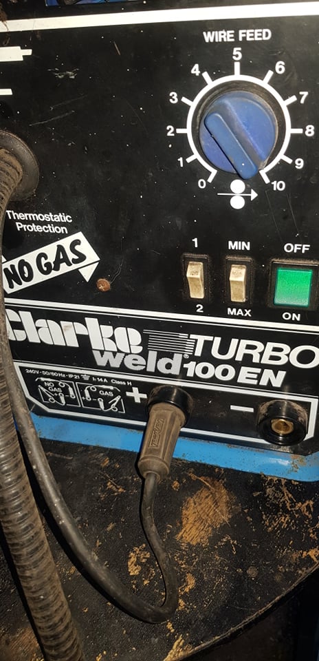

Diodes are a little black but they seem to be intact, source of the issue is these two wires were touching [check pic 2].
