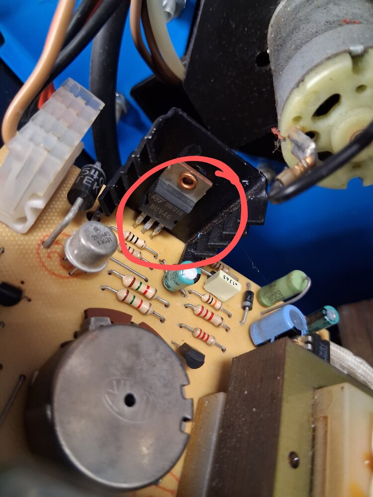

Good advice - but I'm trying to determine whether the difficulty in getting a decent weld is down to my own rudimentary welding skills, or the possible shortcomings of the machine which was secondhand to me, and which I know has been messed with previously.If it works don't fix it!
Good point, thanks.I suspect the component is original given it is copper riveted to the heatsink, doubt anyone would do that DIY. Might have been unsoldered complete with heatsink for testing and refitted though.

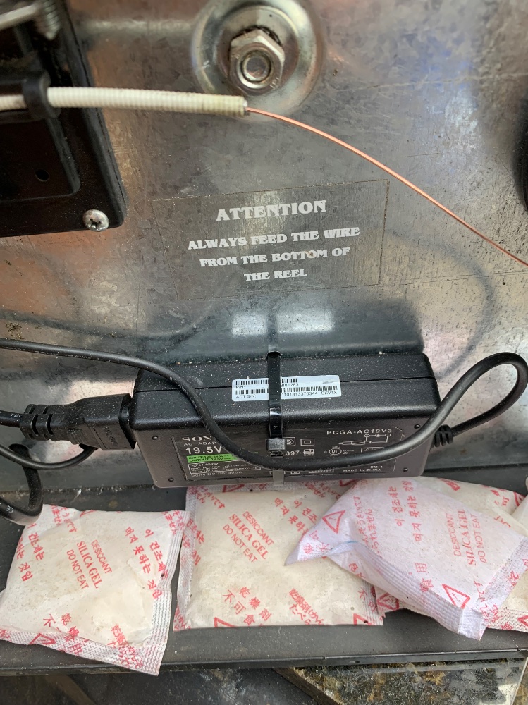

I assumed it was just a cheap welder but I wasn’t too fussed as I’d got it for a song as a non working unit. The fault was just a switch on the front, halfway between,

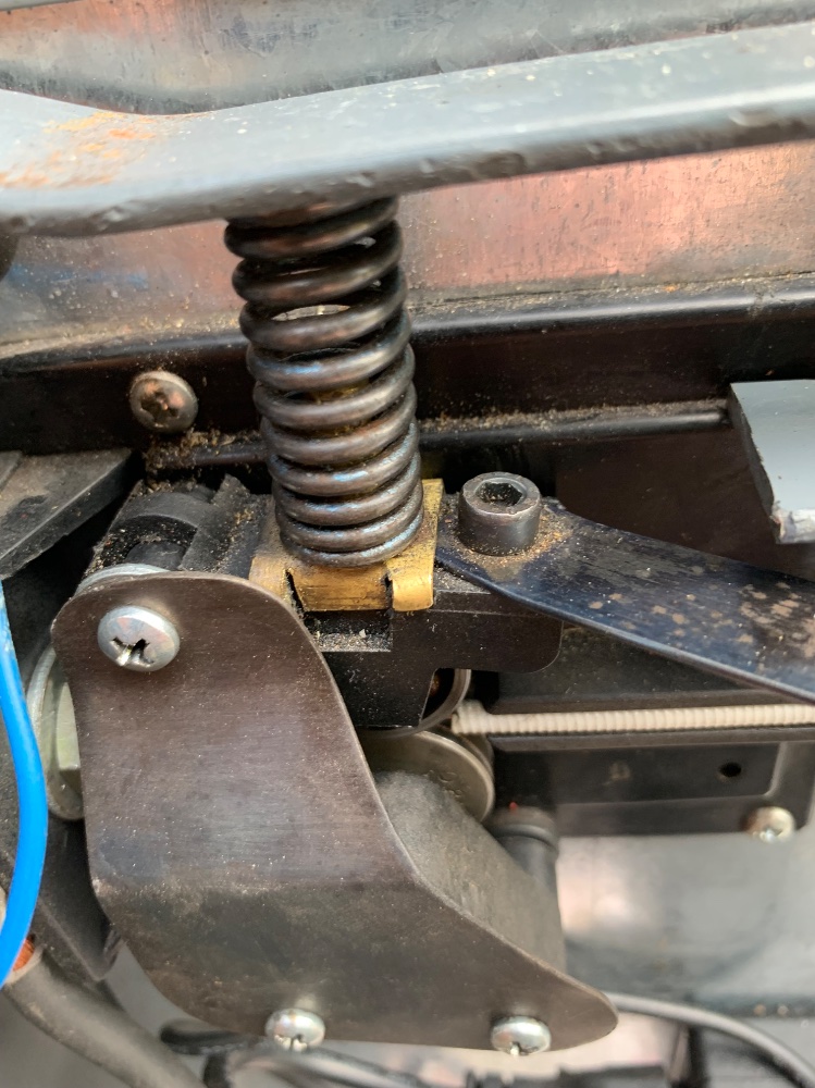

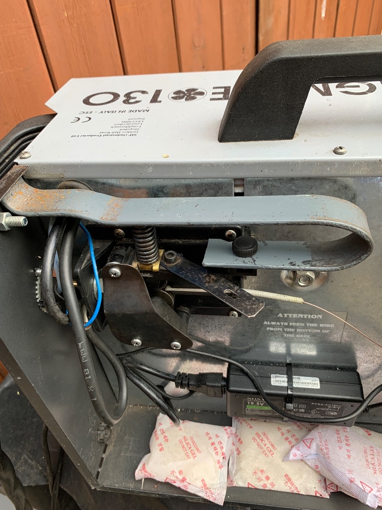

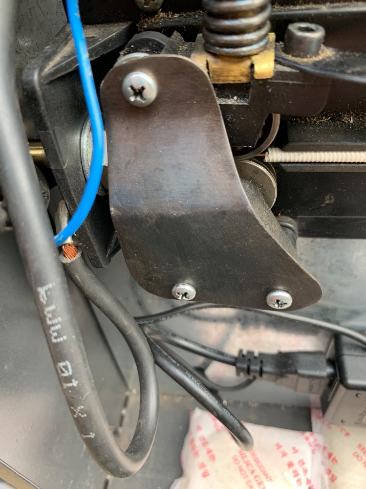

I modded the wire feed bracket. Made my own wire feed pressure arm. Fitted a steel liner to replace the plastic one. Fitted a separate power supply for the wire feed motor. Fitted a separate wire feed trim potentiometers and ditched the pub co2 gas for a Hobbyweld argon/co2 mix.
WHAT A DIFFERENCE IN THE MACHINE NOW.
When it welds it sound like bacon sizzling
All this was due to the massive help I got from the lads on this site
I’ll post a little video later of my modifications.

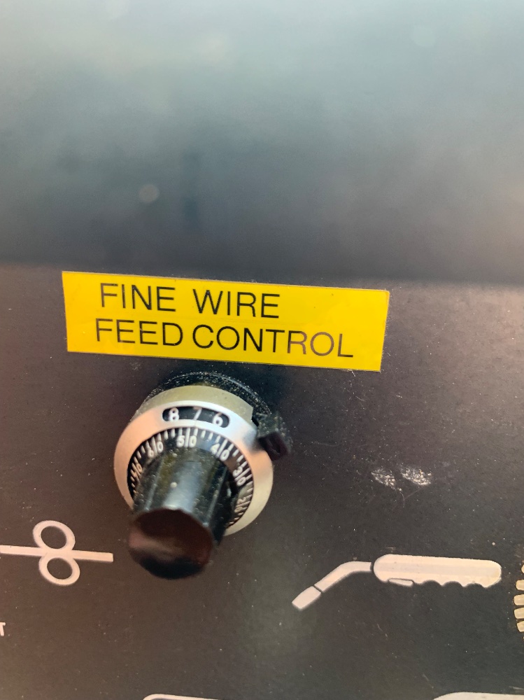

There are many variables to consider and your description isn't very detailed.Thanks everyone. I am having great difficulty in getting a continuous weld with good penetration. The manual suggests that the feed speed should automatically change with different switch settings, but mine remains constant across all settings, when measured across the motor, with the trigger pulled. I can though, change the speed on the rotary control quite effectively.

The wire feed indeed changes with power settings so it's more or less set and forget.
To test the changing speed, flip the wire feed pressure roller tensioner down so the wire won't feed. Pull the trigger in all power settings and you should hear a subtle change in the wire feed motor speed.
To refresh, tell us what wire you're using, polarity config, what you're welding, welder settings etc.
Are you using flux wire and not mild steel wire if your on no gas settingWow! Some mods there Alan! Thanks for the pics. I'll bear these in mind

I have looked for a variation in the feed speed, by checking the voltage at the feed motor, which I thought may make it easier to discern any speed variations that a visual check. At any given voltage (as set by the rotary knob) the voltage remains constant across all current settings.

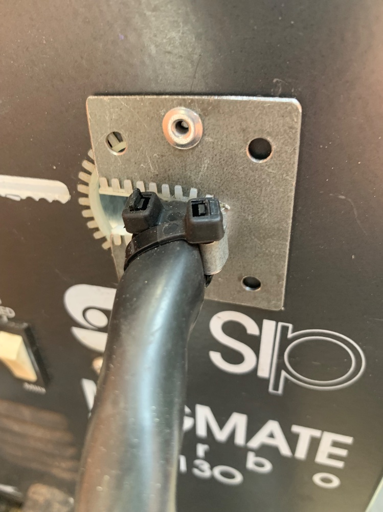

I am sure that with my 0.8mm practice sheet, I should get a semi-reasonable bead. I am on no -gas, with the polarity set accordingly. Having checked, cleaned all the switches and connections, replaced the earth clamp and replaced the aluminium splice with a four terminal earth block, I'll see how she performs over the next couple of days. Thanks again.![]()
Is the wire feed motor PWM driven? That would appear as a constant voltage on some DMMs. You can't go wrong listening to the speed of the motor... unless you're tone deaf!
