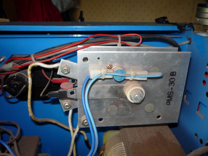

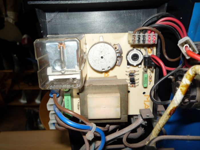

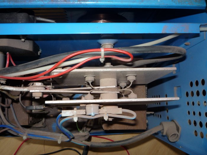

i recently got a clarke 100E mark 2 that was broken with the plan to have some fun fixing it. the problem is that nothing happens when you pull the trigger, there is gas but no wire feed. im wondering if anyone can help me with trouble shooting?
what i have looked at so far:
there is no obvious burnt components on the p.c. board and doesn't look like there are any gaps where there shouldn't be on the foil bit of the board.
the relay doesn't switch when you pull the trigger, if you manually switch the relay the wire feed works fine and it welds as normal.
measured the resistance and voltage across the coil of the relay and there is a small resistance so would guess its not burnt out and there is no voltage with the trigger pressed or not.
i also measured the resistance across the two sides of the switch in the torch and got very confused as there was one, about 102 ohms, but guessing it should be like that
as i would expect it to be less if it was shorting inside the cable.
if people have any ideas for things i should check it would be much appreciated.
and iv added a picture as it just wouldn't be the same without it
cheers
Aj
