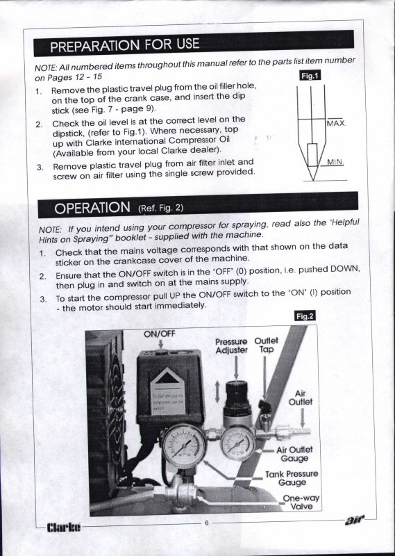

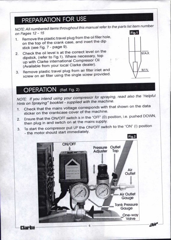

I have a Clark 8/35 tiger turbo compressor.This was cutting out after building up to the cut off pressure.
I was told by Machine Mart I needed a new black regulator box with the switch on it.So bought and fitted this and stripped the machine cleaned up and checked all I can.
Now same thing happens,I start up it gets to cut off pressure and lots of air hisses out of the black box area and the compressor shakes and motor cuts out and the trip on the compressor pops out.
It will start again but same thing happens.
Any advice would be great...thank you.
