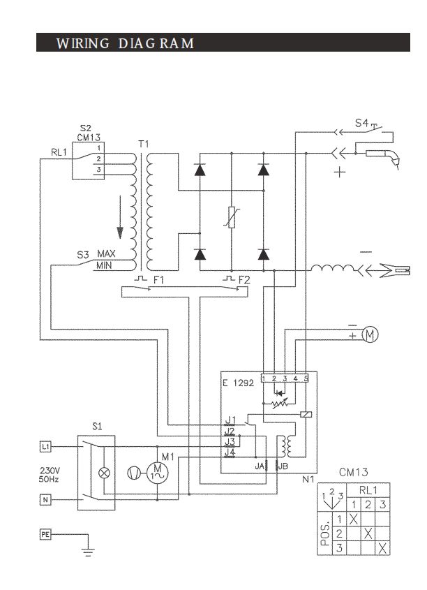

Hi I have bought a TECHNIK DL-15 euro torch conversion with a gas solenoid but got it off ebay from Germany and no wiring diagram and I've no idea where the two red wires go to make the thing work or what the solenoid wires up to (emailed them to see if they had a wiring diagram got a fantastic reply ''NO'' thanks a bunch) any help would be much appreciated
cheers Craig Cameron
