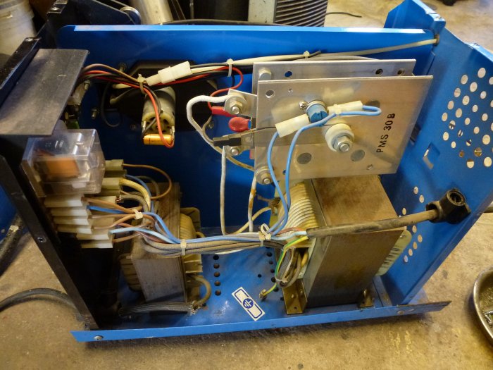

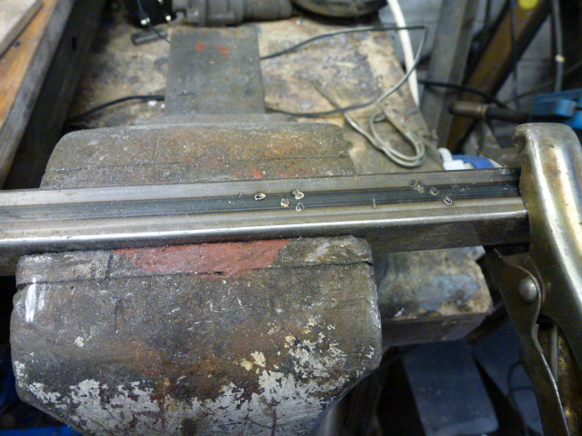

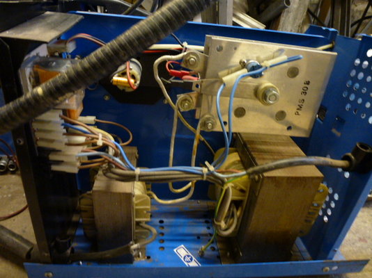

Hi found the site very interesting but cant find any problem like mine,
I have had the welder for several years had no problems till this week, welding thin gauge pipe just stopped welding!,can any one help?
what i have done so far,the wire feed works until you the arc strikes and the wire burns to the tip
checked gass ok
checked relay cleaned contacts ok
checked rectifier ok
24v from tip to earth
loaded tip to earth 10amp have nothing bigger no problem
long shot but it looks like the wire is heating up in liner?pos?
