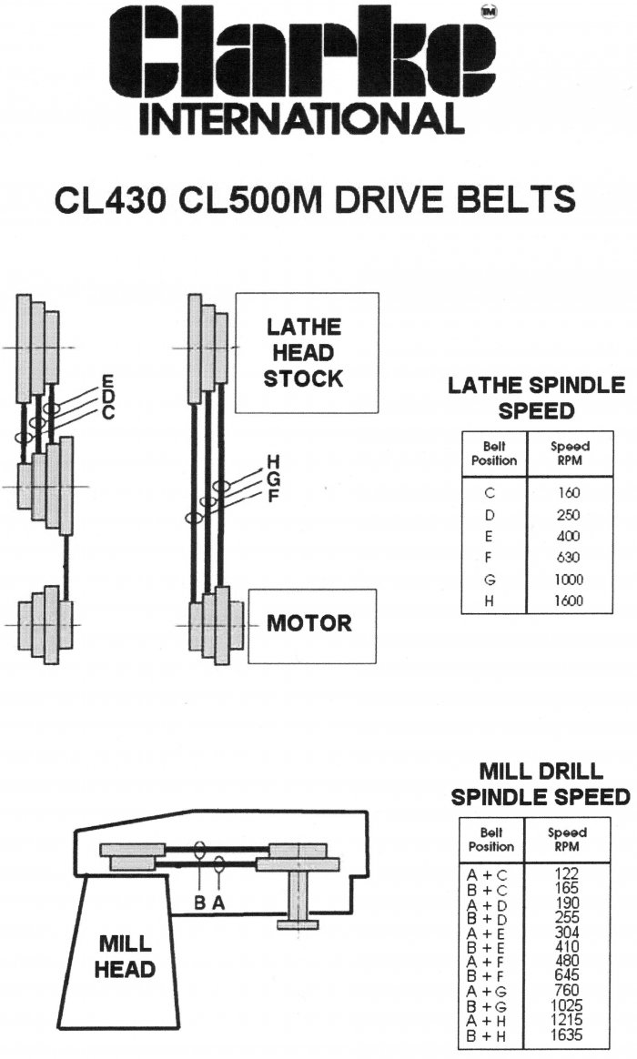

N naughtyboy Guest Mar 5, 2013 #1 the manual that comes with the cl430 lathe is wrong on setting speeds. hopefully below is updated version from clarke there is small pulley behind large one on motor. img013.jpg 101.1 KB · Views: 258
