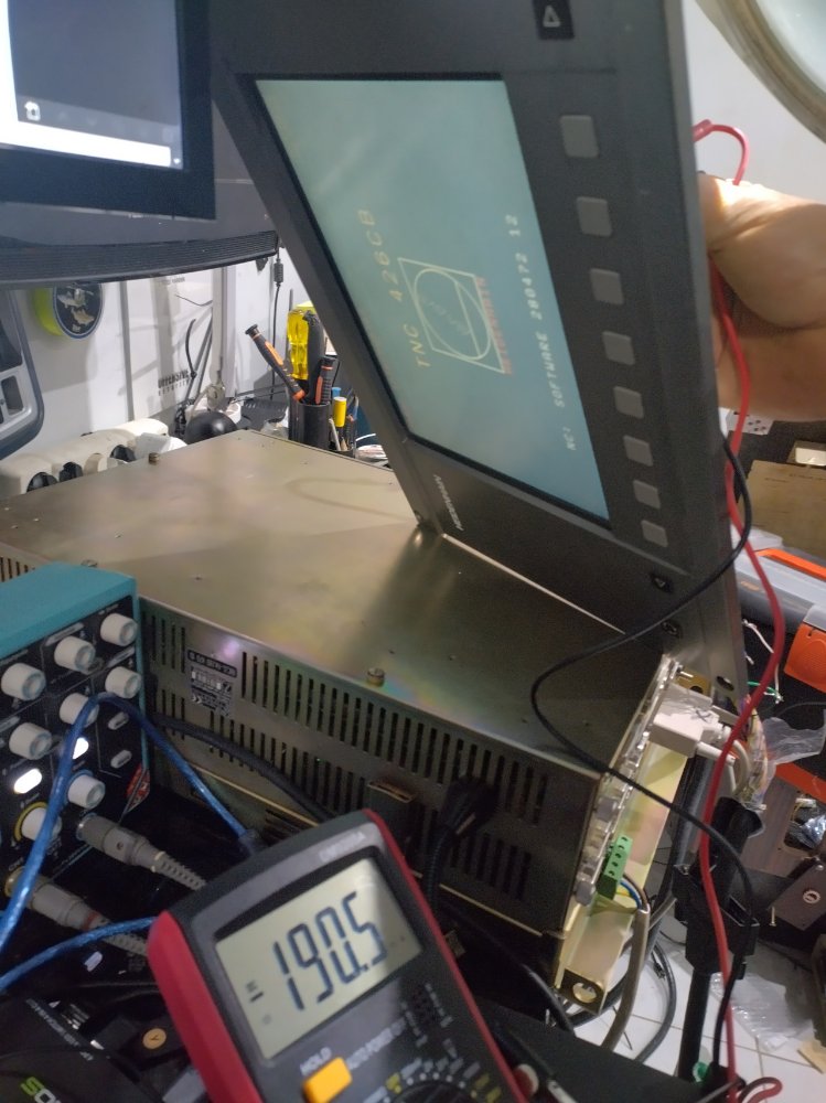

Bit of a longshot but as per the "things you fixed today" I almost got my Sabre 750 cnc machining centre up and running but the hard disk failed on boot. Its bad electrically, I can hear the heads tracking while its trying to sync and it never even answers the ide identify query. So its firmly a case of its dead jim, electrically. The broken disk drive is going off to a lab in Prague to see if any of its readable after parts replacement, but in the past results of that have been a bit hit and miss with such a old oddball drive.

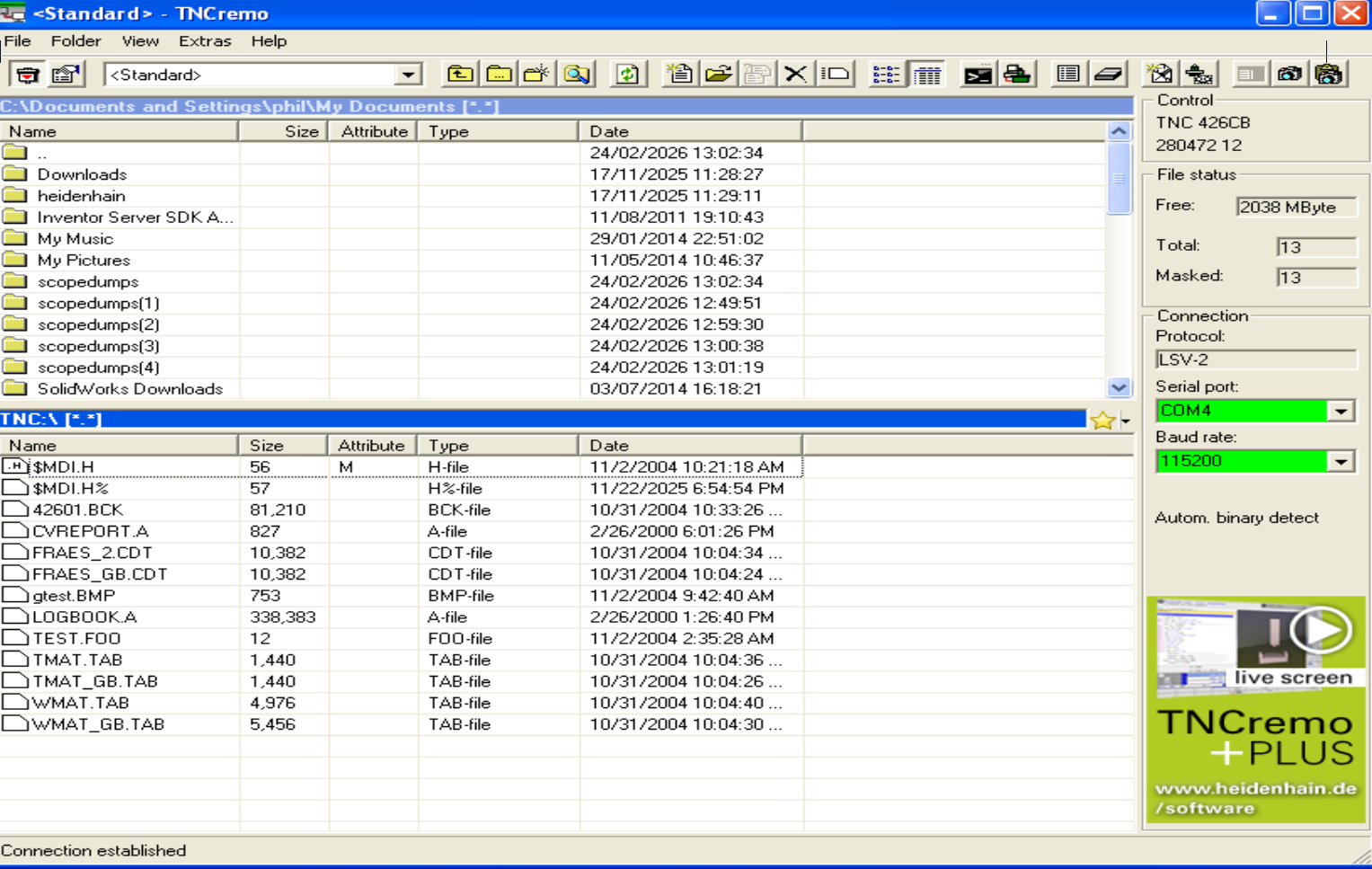

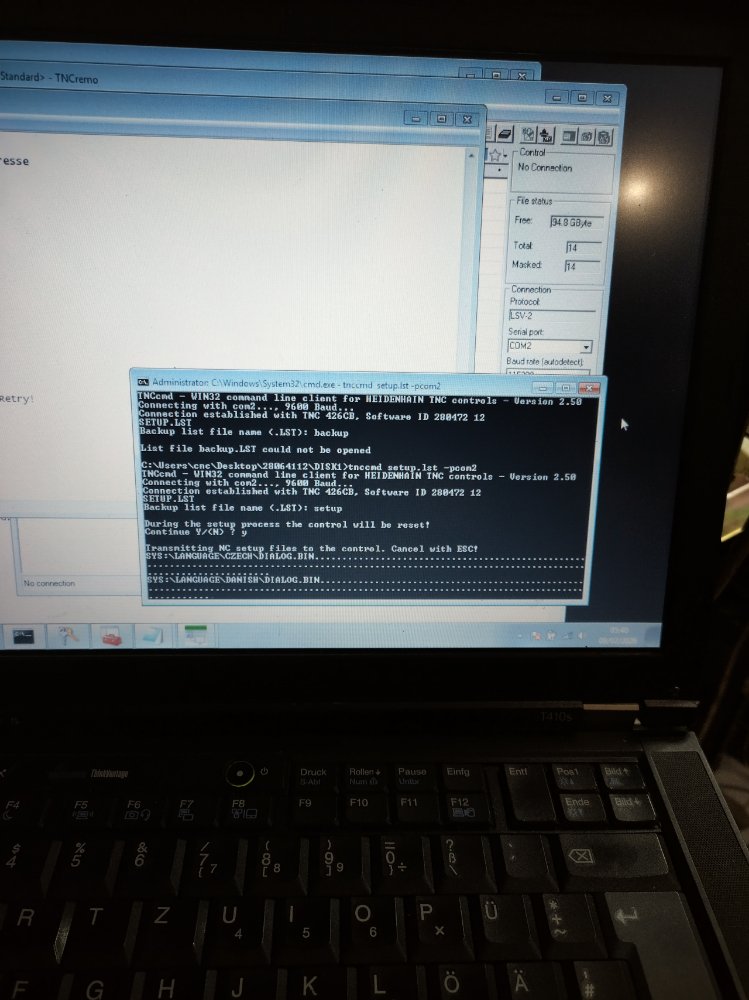

I've since replaced the hard disk and formatted the replacement in the machine, and installed the matching version heidenhain software again via tncremo, but this installed default safe heidenhain parameters and while it boots and is on the network now, it has no concept of what sort of machine it is in. The part of the configurtion that tells the machine how the heidenhain control is connected and how many axis/travels/limits/spindles etc and where its connected is supplied by the machine manufacturer not Heidenhain themselves, and Cincinnati Milacron milling machine division went defunct in 2008. Out of curiosity I read the replacement drive in a linux machine and its all normal fat16 partitions with regular fat file tables etc.
