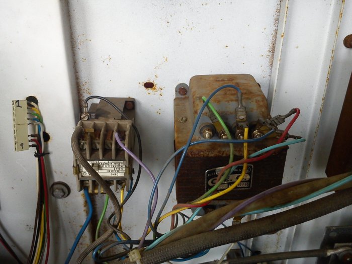

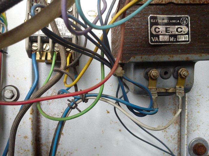

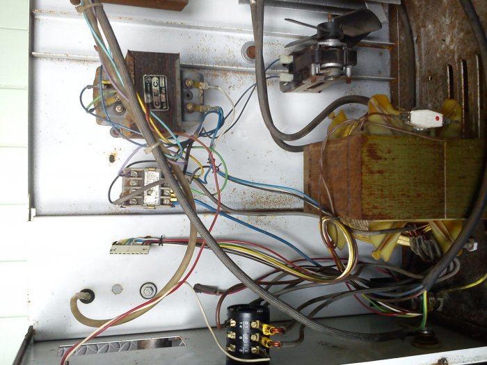

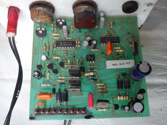

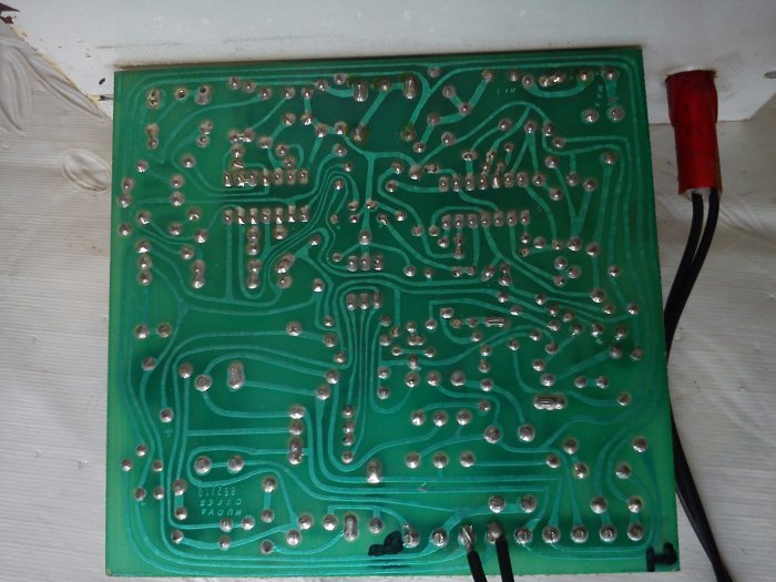

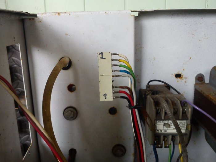

Anyone got any idea where I could find a CIFES 180 Mig control board these days, I'm drawing a blank everywhere.
The connector (bakelite type thing) on it cracked and one of the terminals came out, soldered it back on but when I switch the welder on the main contactor for the transformer closes and the gas valve opens, so I'm guessing that part of the circuit has shorted somewhere but I'll be ******ed if I can spot it on the board.
It's not the torch connections or anything as the wire feed/spot/stitch function still works properly with the torch, so I'm assuming whatever has gone is what killed the terminal/solder joint on the connector (or I've put it back together wrong
), and it's powering/earthing the main contactor/relay.
