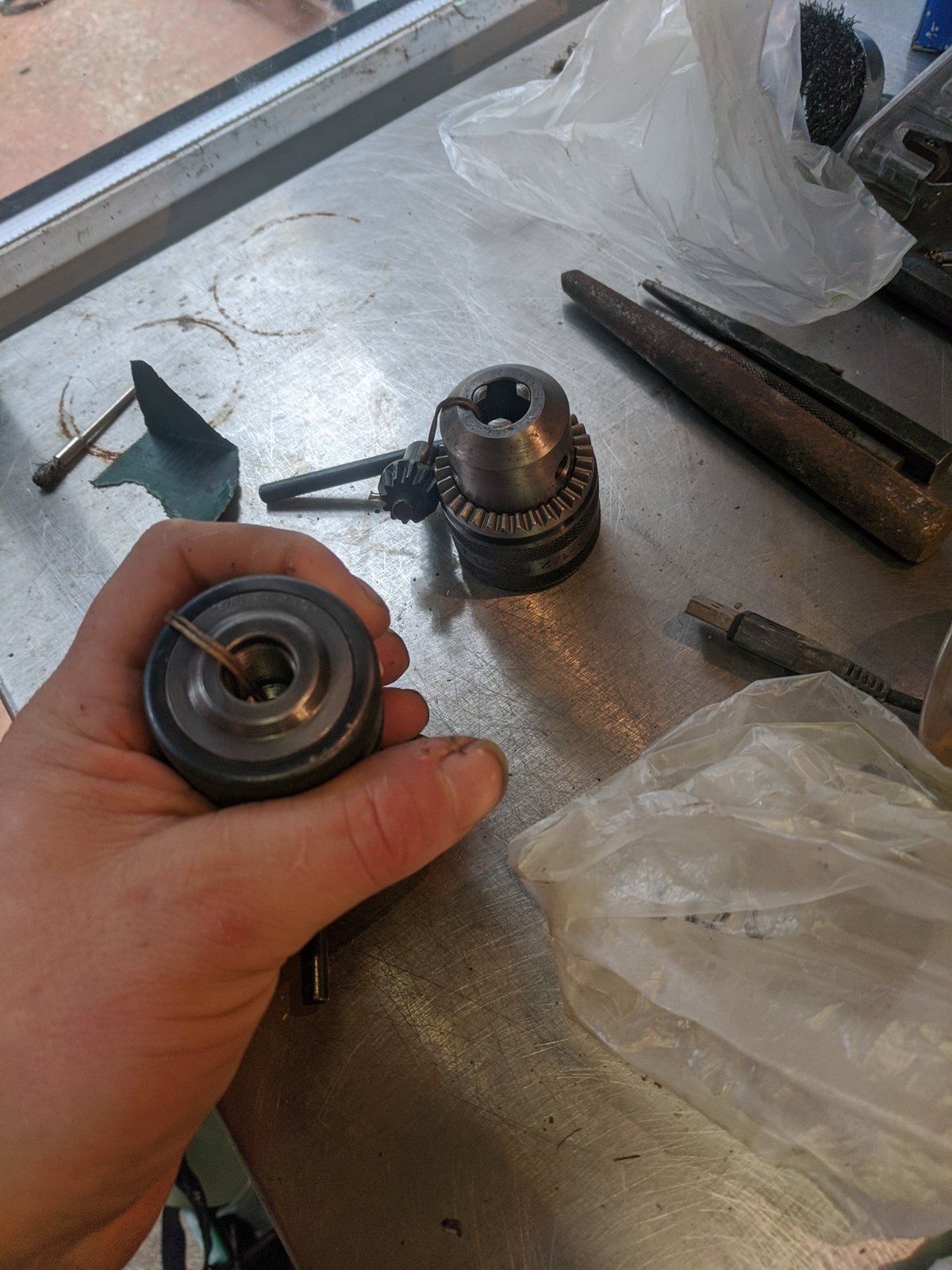

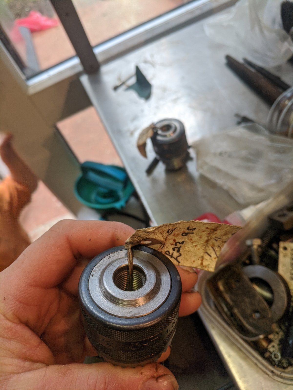

Open the jaws up and see whether there's a screw going into the spindle, if there is it's a screw-on (often 1/2" UNF) and the screw in the middle's left-hand (don't ask me how I...)Kind of a repost from another thread, but im wondering if anyone knows about this chuck -
and, more specifically, if it would be possible to change it to something that would hold a 9.5mm dia shank?
Thank you.
