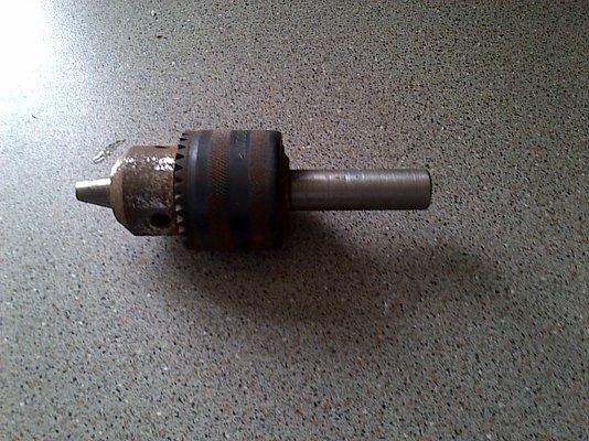

couple of bits i made as learning exercise on lathe.
1 is a chuck adaptor to fit a smaller chuck into my 16mm drill press chuck for drilling small ( below 6mm ) holes turned one end down to 15mm then othr end to 1/2" and threaded it 1/2"x20 to hold 10mm chuck.

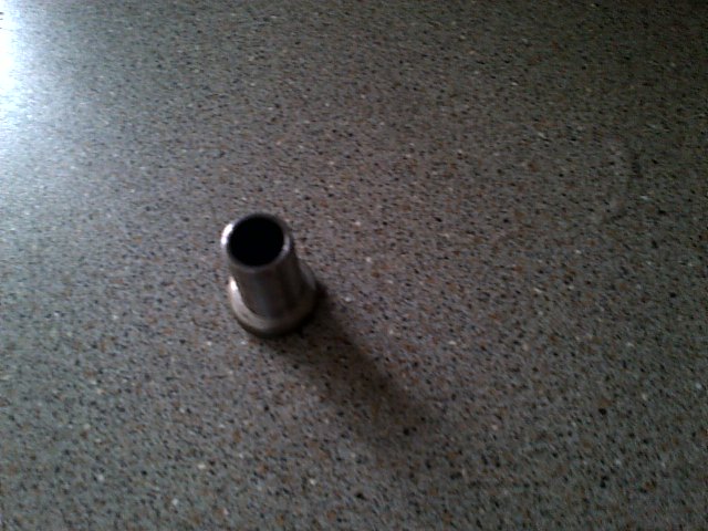

2 is a tapping guide made from 20mm rd to aid in keeping tap square for some m10 holes i had to do, worked a treat as well.
smaller dia is 14mm lip is left at 20mm.
next job is to make up full set for 8,6,5mm
