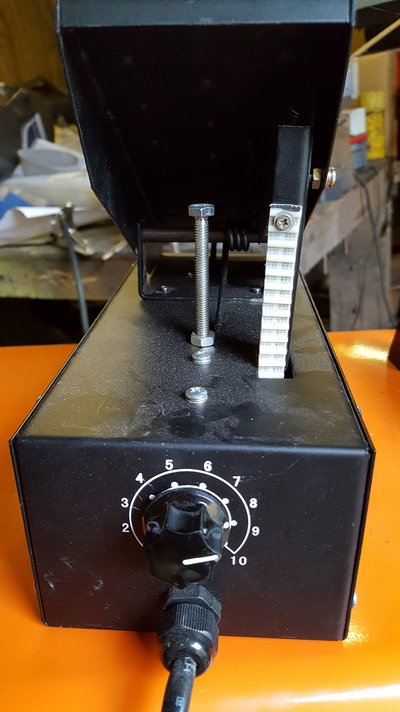

It came with a foot pedal that wouldn't turn off consistantly.When the pedal was plugged in with it's 7 pin connector (not sure what they're called) a HF electrical noise could be heard from the machine and I got a shock when I touched the TIG torch connector to check it was on properly and not blowing.
When I got the machine home I took the pedal apart, adjusted the microswitch and fixed that issue. Then I adjusted the travel on the pedal and the start and end points of the main pot to get full range from it as it was set up all wrong. When I tested it I realised the amp adjustment is backward. Instead of it starting with low amps when touching the pedal and increasing as you put your foot down it does the complete opposite. It starts high amps and gets lower as the pedal is depressed. . it has one main pot actuated via pedal action and another one wired in line adjustable by hand to use as a range limiter to the main pot. I checked the soldered connections on the pots, connector itself and inside the box and all looks factory with shrink tube. Could the factory have made such a mistake? The seller didn't seem to notice and wasn't keen on using this pedal and had upgraded to an AC/DC machine with a new pedal. I'm thinking of switching the connections at the main pot or switching over the pins in the connector. Which seems the better way to go?
