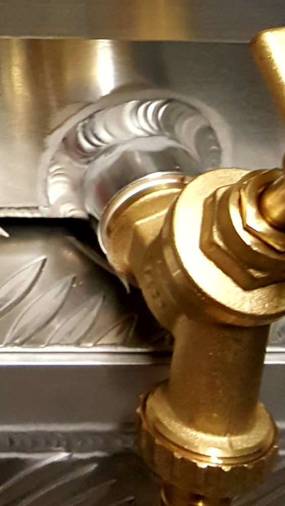

C Cheesie Member Messages 1,259 Location Lisburn Feb 21, 2021 #1 Didn't think the filler spout was going to weld at all
F finyuk2005 Member Messages 903 Feb 21, 2021 #2 its not because it was anodized was it? or just dirty monkey metal?!
carbon Member Messages 3,102 Location S. Glos. U.K Feb 21, 2021 #3 The lack of cleaning zone on the filler neck and the poor finish of the weld to me would also suggest that it’s anodised

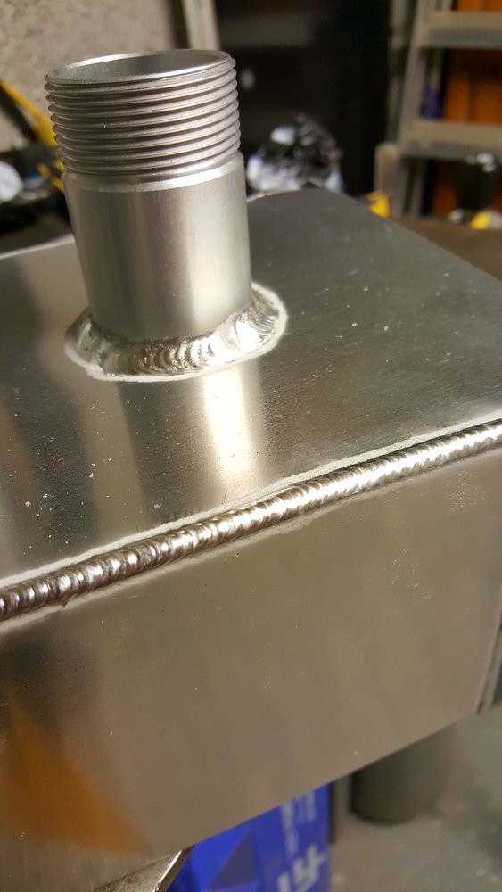

C Cheesie Member Messages 1,259 Location Lisburn Feb 21, 2021 #5 still not as neat as I'd like but at least it welded as it should ordered from a different place
