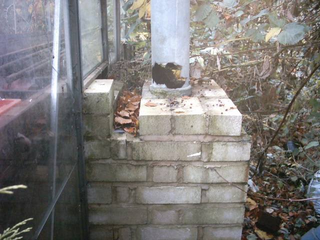

Steel pipes were one of my ideas, but i found some asbestos pipes.I would advise NOT to use asbestos ones. I built a greenhouse heater/boiler and exploded the chimney as i was using coke. (i wasn`t on drugs i was using the smokeless fuel that generates an enormous amount of heat). The blast blew a hole in either side of the chimney. It actually "draws" really well with these holes in the side (a bit like them old bunsen burners that we used to use at school).
If you only need a small chimney to go out of a garage/workshop, you could use some old cast drainpipe. If doing that now i would drill some "draw holes" in the side near the base-(see pic of the blast holes in the asbestos pipe)
Asbestos exploding sounds like a shot gun being discharged and you dont want to be with in 3 mtrs if at all possible.:scared:[/QUOTE said:Your not wrong. I was in bed at the time, it was about 1am-it sounded like world war 3.Had to rush down and throw buckets of water on the cokes to out them-you live & learn.
