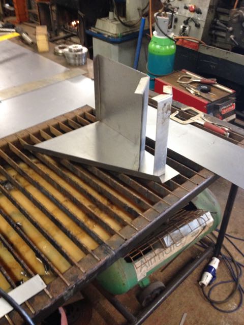

now i am limited to 1mtr wide on metal work as that is how wide my folder is.

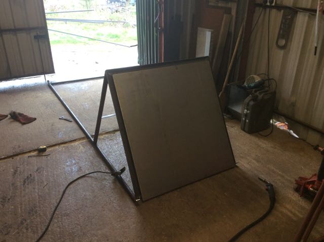

First off make up a frame that is on two runners that will let it skid around the grass with a nice big door for access to the living quarters. It will be moved every few days so they have some fresh grass to eat and before the pile of pooh gets too big

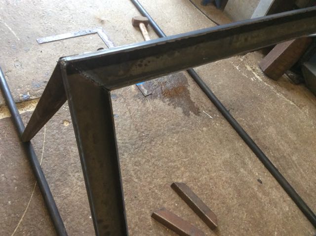

The door has folded edges which sit into a frame to stop water getting inside. the frame is made from 50mm box section sliced in two

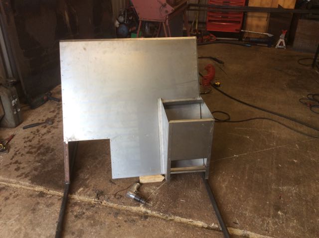

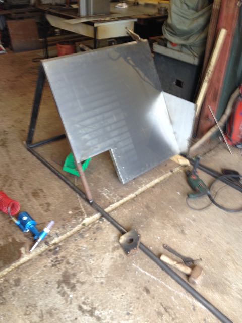

The side facing the run is fixed with a hole for the chickens to pop in and out of with a section sticking out the side panel.
Which is where the food will go
So a hopper type feeder will go there which will be attached to run. So when i move the run the feed comes with it. >mental note must clean out the plasma cutting bench<
