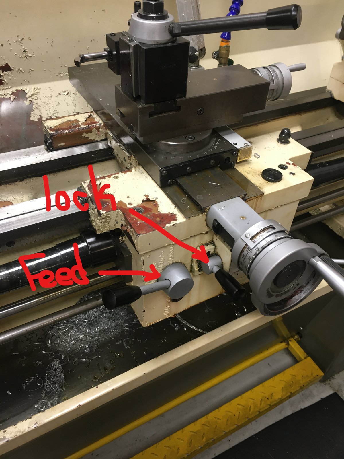

Hi All, we're attempting to cut a large thread on our Chester Challenger lathe and coming across a problem which is very frustrating.
We're happy how the lathe is setup to cut the thread except it won't let us lock the apron and engage the feed at the same time?
To me this seems fundamental to make a repeatable cut in order to make the thread.
Has anyone got one of these lathes or had a similar experience?
