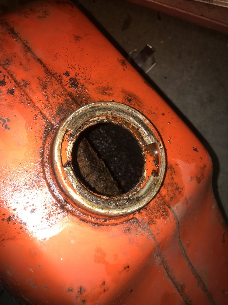

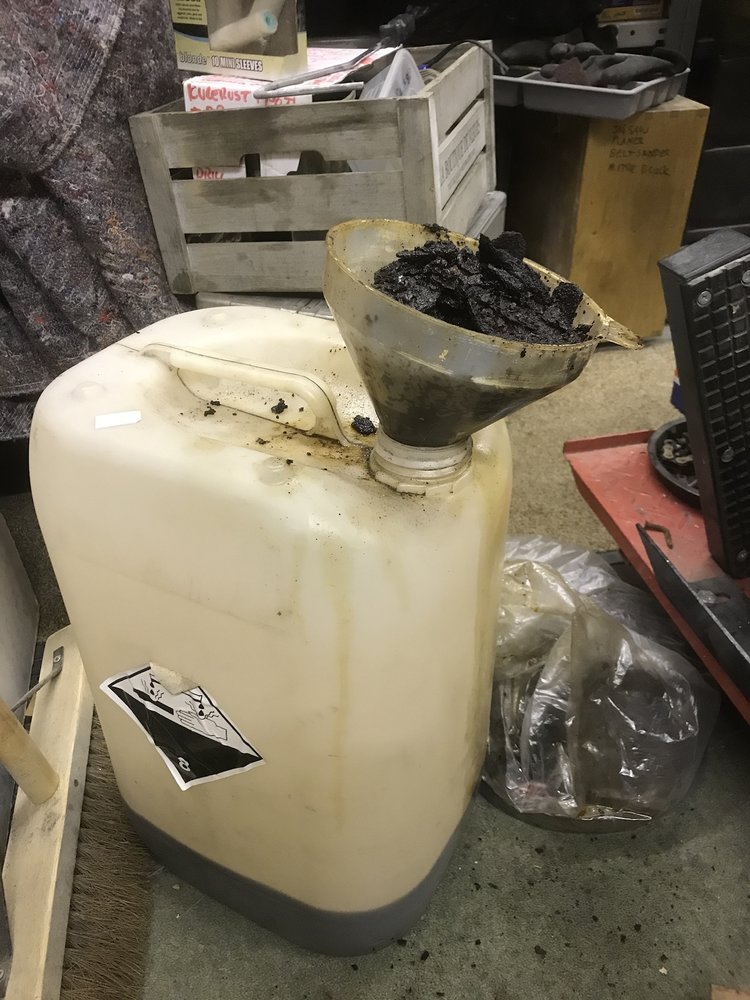

That ****e that’s looks like stone is old petrol!!
