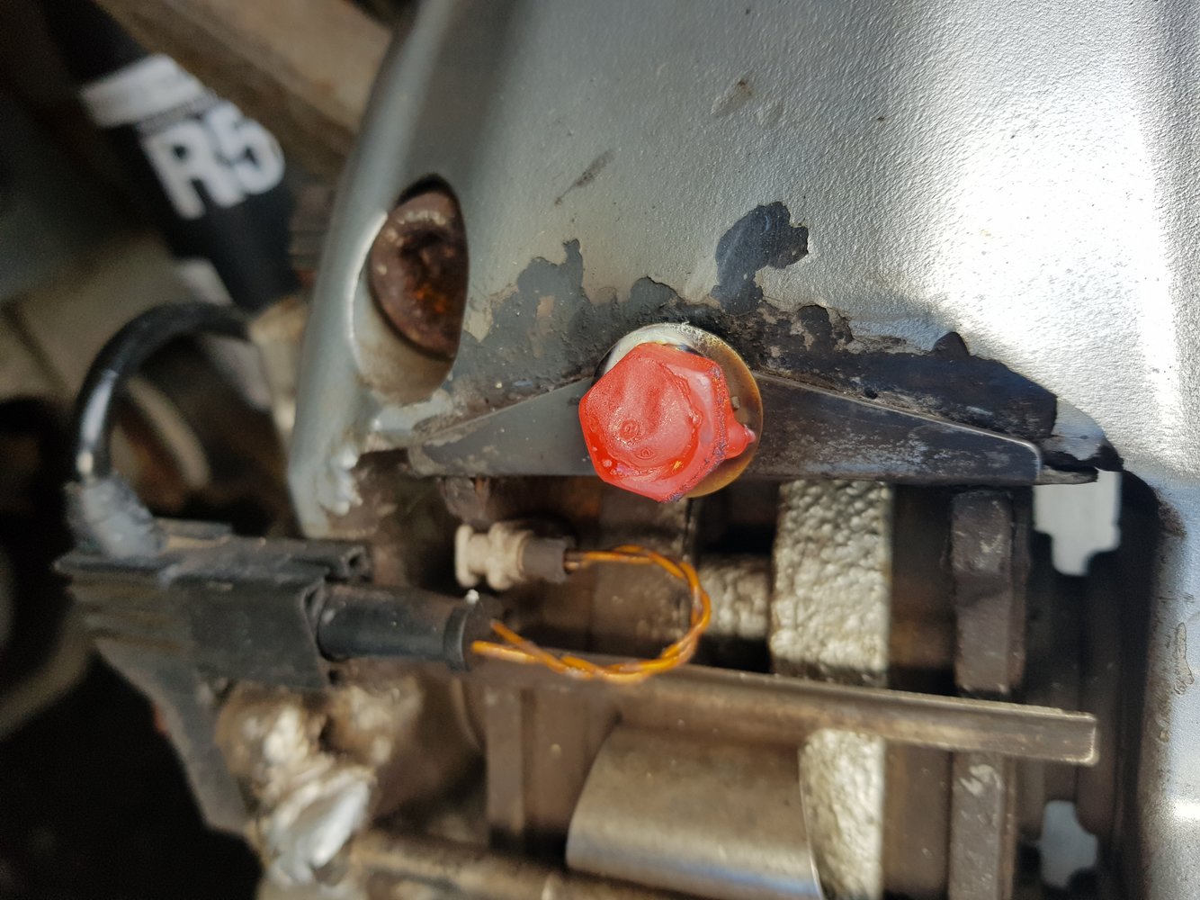

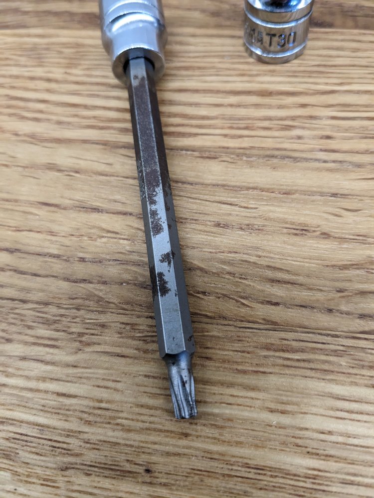

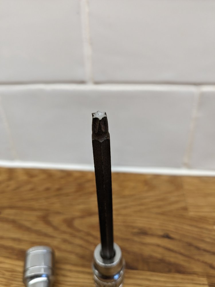

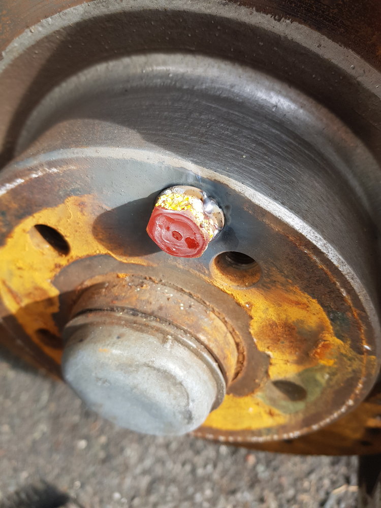

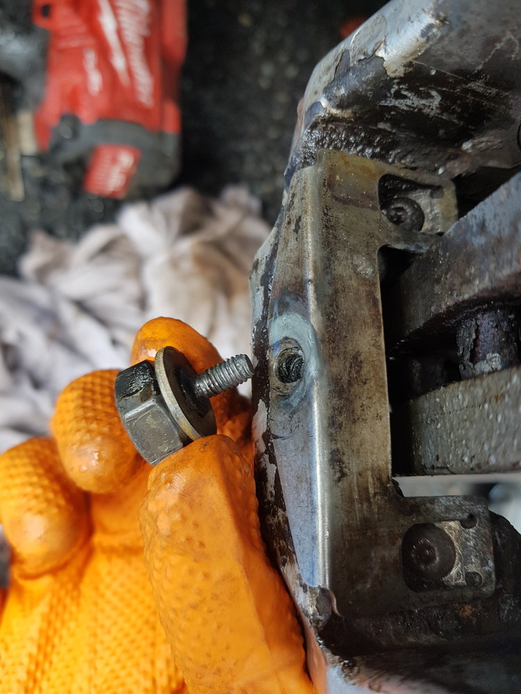

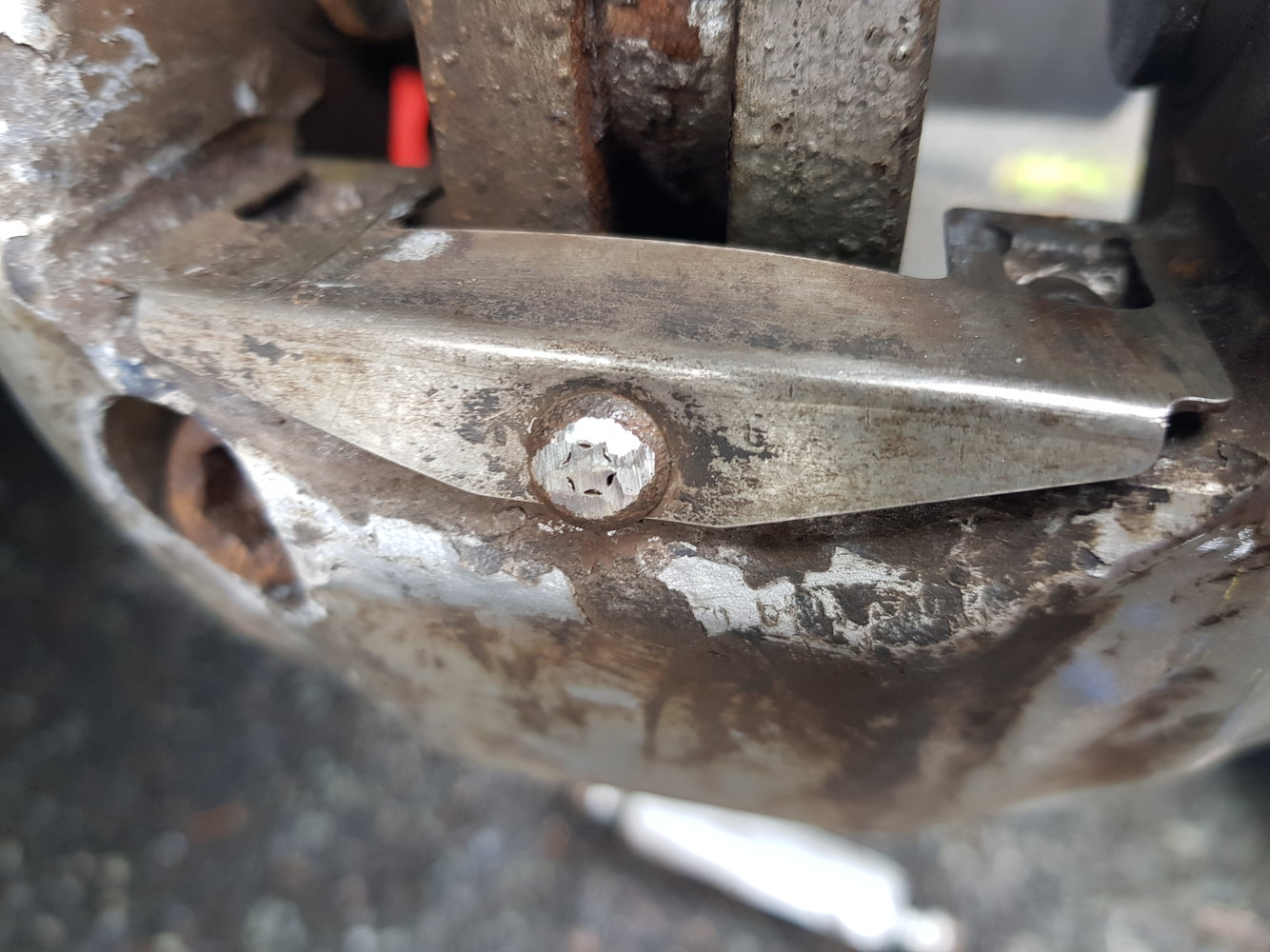

I do rate Halfords despite what some people say.I helped my eldest boy change his front brake pads today and needed a bit to remove the Torx bolt on the disc so I got out my set of US Pro bits and this happened!
View attachment 401750View attachment 401749
The bolt wasnt even that tight!
Total cheese
I'm off the Halfords with my birthday vouchers now![]()

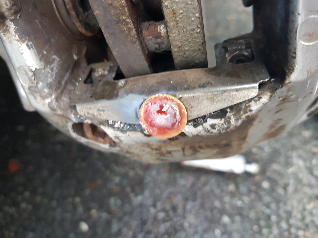

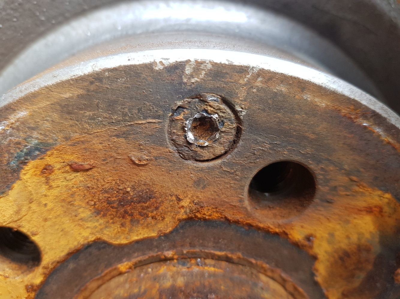

With stuck ones I have had great success drilling out the torx splines in the fastener so its round. Then hammering in an appropriate sized splined bit and using one of those impact drivers you hit with a hammer. The splined bits seem much stronger but seem to give enough grip to turn it out.
Urwin ?unwin?
To be honest, I never bothered initially with the Torx, just a BFO centre punch & hammer around the periphery then Torx bit once it had moved 'a bit'.
Never had any issues with Merc. ones as they are flat not countersunk and have a relatively small contact area - that said, they (all of them) are only there to locate, not secure the brake disc and overtightening is the biggest cause of problems.Yes user error me thinks.
Anyone can break a torx bit if careless.
I have some US Pro torx sets and haven't had any issues. I also don't abuse them so there is that.
Brake disc torx bolts are always a high risk. Mercedes ones come with lock tight pre applied.
So I heat them with a MAP Torch first to soften any locktight then smack them with a large hammer and shock the disc also. Then undo it.
Nah not user error. Just soft ****e steel tools!Yes user error me thinks.
