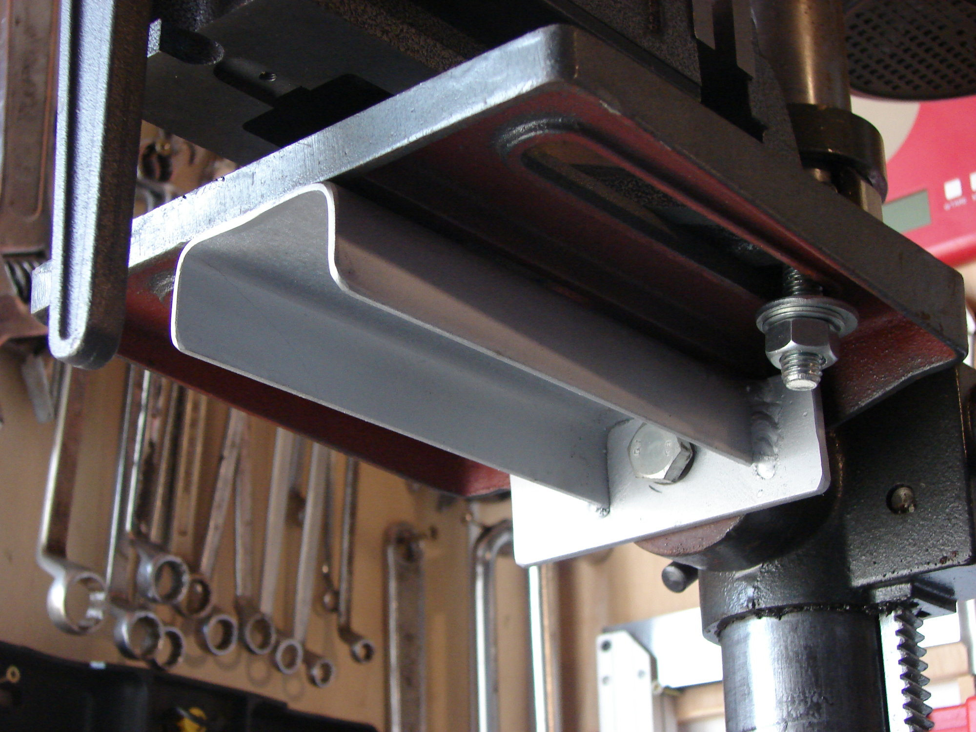

My next effort was an attempt to stiffen the slightly springy table, just a piece of channel welded to a piece of flat bar and held by the pivot bolt. Another success in that it certainly deflects much less under pressure.

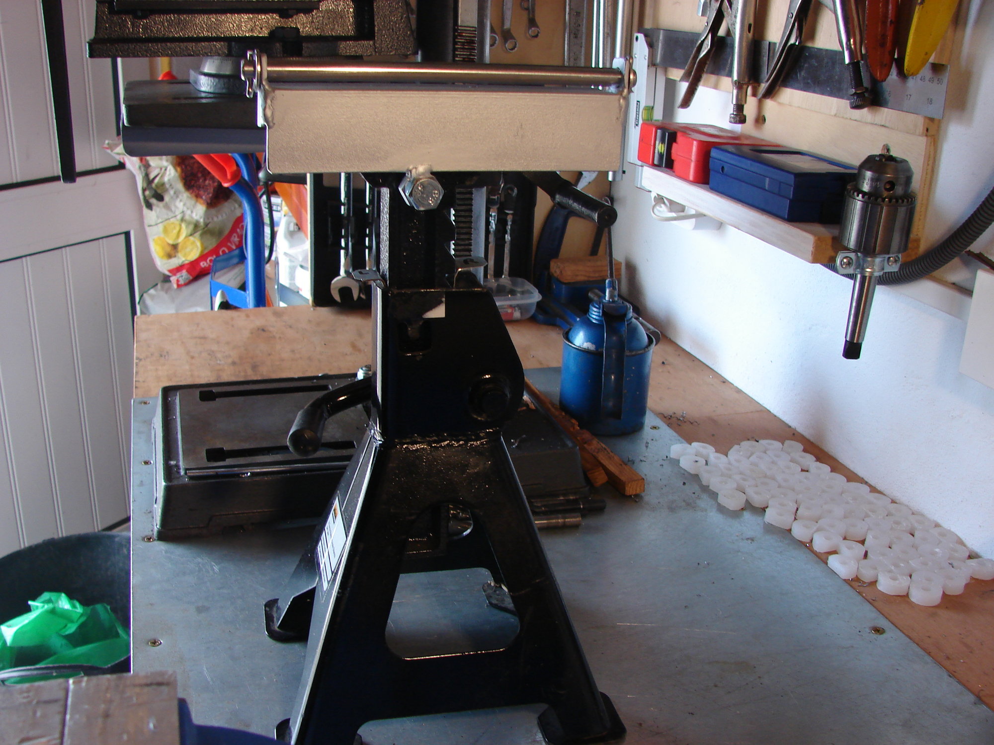

Finally, a little, what would you call it? An extension table? Anyway, made from an axle stand, and which can be returned to its primary use by undoing two bolts.
