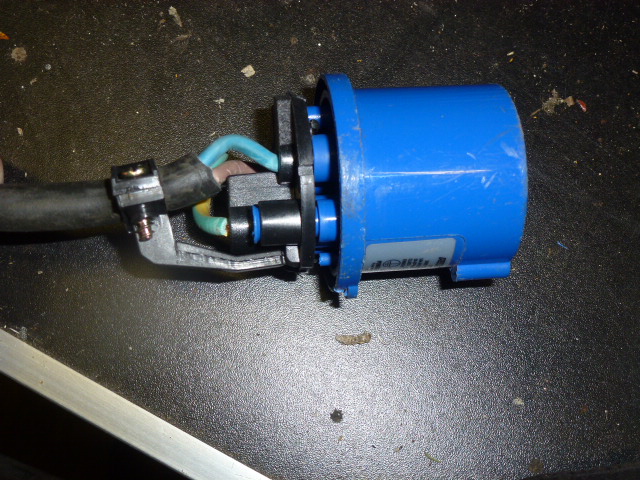

This is what I found inside the 16a plug!
It looks like something cobbled together by Mr Bean!
The outer rubber sheath was a very tight fit in the gland on the plug cover because they hadn't trimmed it out enough for the 2.5mm flex.
Because of that they couldn't get the flex in far enough to reach the cord grip so they added a single layer of heatshrink sleeve to 'protect' the cores & tightened the cord grip loosely onto that.
All the copper wires were stuffed into their holes without twisting the end, leaving the tangled mess you see, the earth wire pulled out when I removed the cover & the screws on the L & N wire were not fully tightened!
It now looks like this, not perfect but 100% safe!
I doubt that it came from R-Tech like this but it would be prudent to check your welder in case!
So my advice to anyone buying used electric appliances - CHECK YOUR PLUGS & LEADS!
