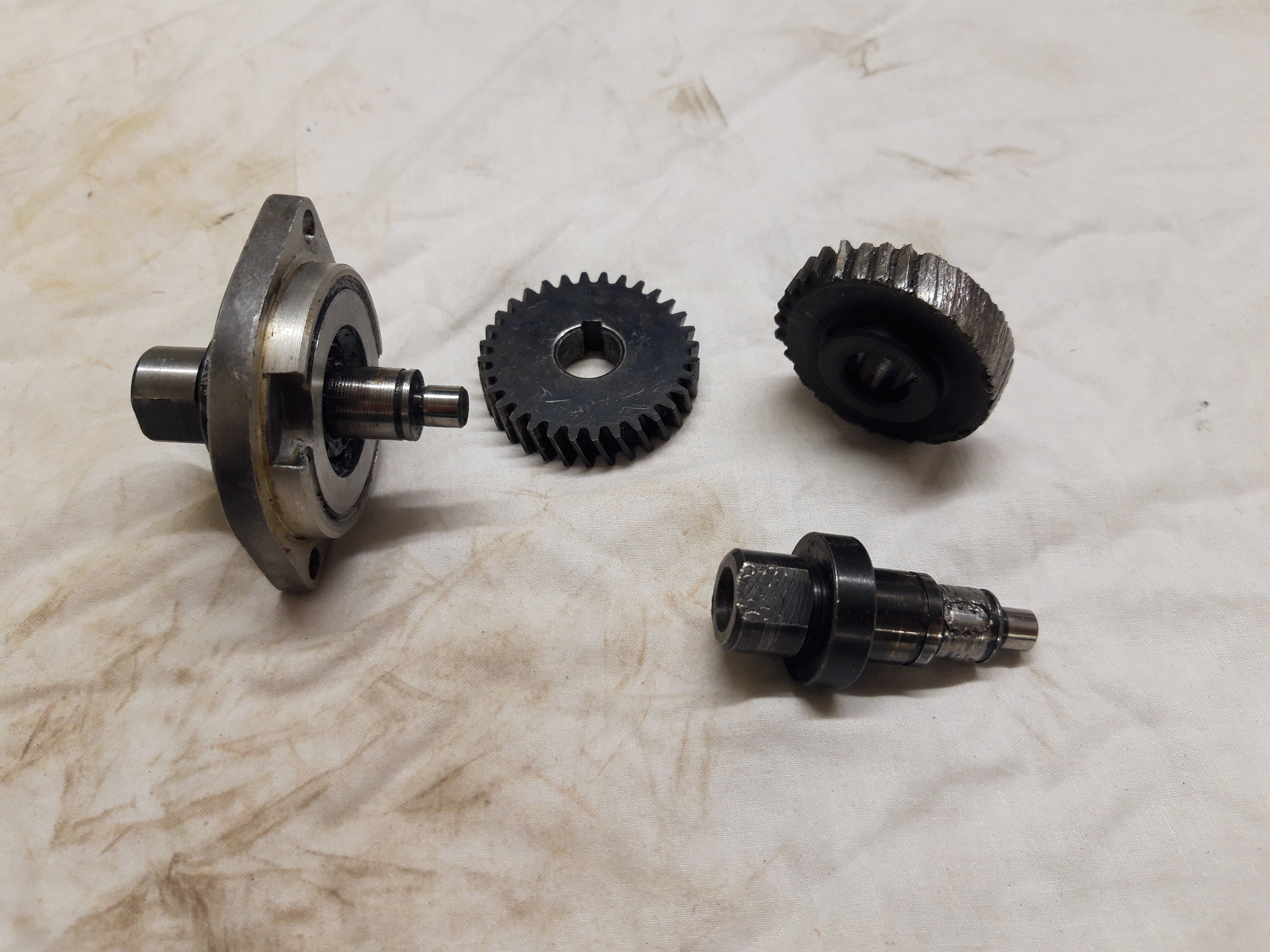

Got two near identical 10" saws. Both being scrapped about 15 years ago. Bought generic spares years back in the day (never fitted until now) from God knows where that fitted one saw. Yesterday, managed to make one good saw out of two. (Mate wants lend of a saw).
One a Nu-tool the other actually branded as "Budget". No doubt both made in the same factory at different times for different buyers.

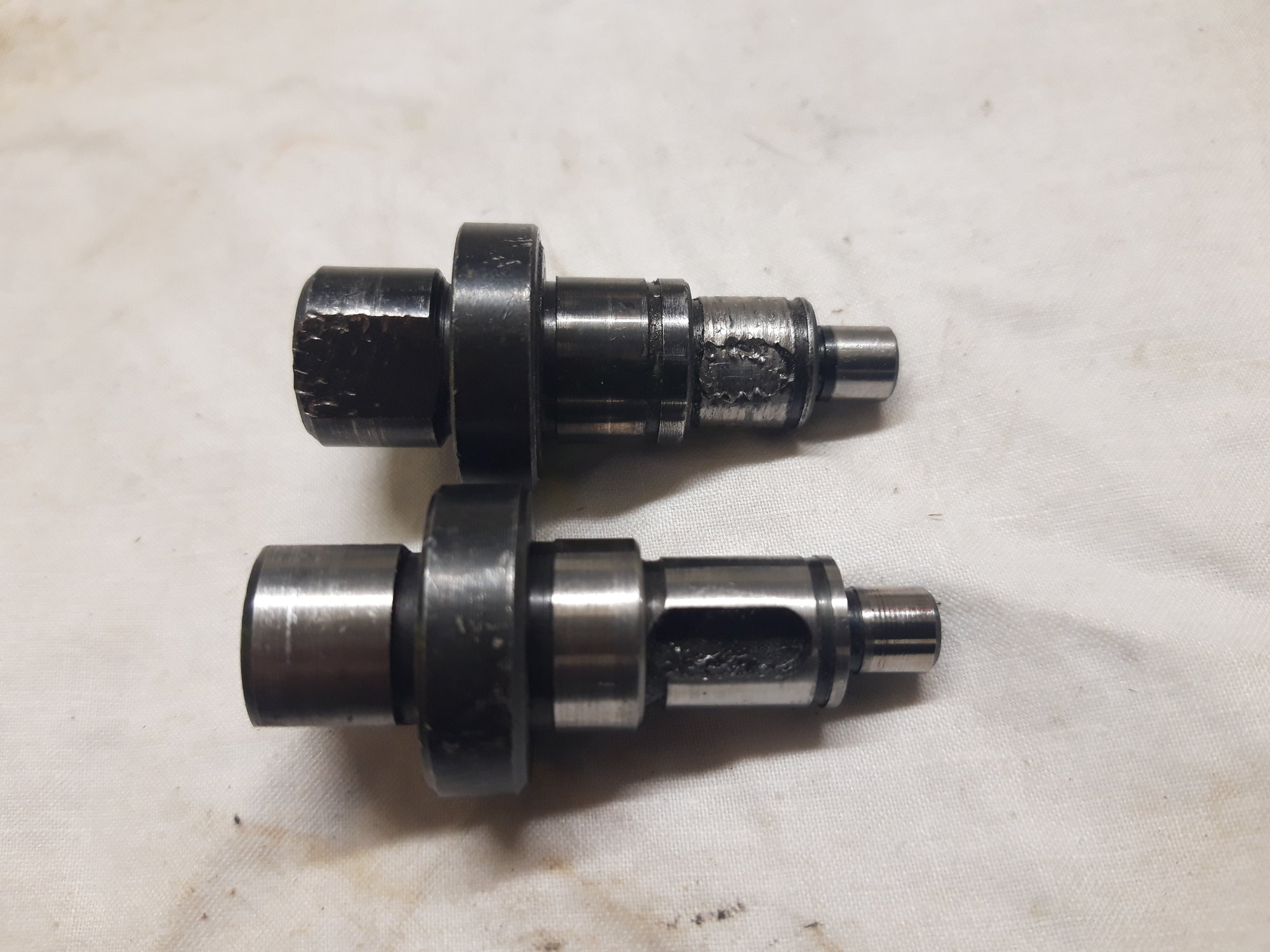

Key stripped on one, drive gear shot on the other.
Any idea where I can get these size drive gears? 43mm OD, 12mm bore, 32 teeth? 4mm key on one saw, 5mm on the other. Tbh with just a 4x4x8 feather key I can get the other saw going but it'd be nice to have a source for the gears. No end bearing or even bush which doesn't help!
Interestingly the shafts are the same length and interchangeable with the appropriate circlips, key and drive gear.
Ta.
