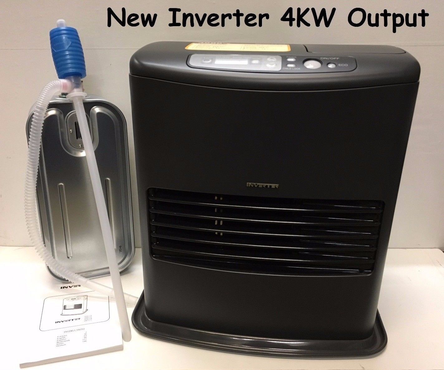

BS 2869 C1 - for flueless appliances:
https://www.britishfueloils.co.uk/bfo-bs2869-class-c-premium-paraffin-spec.pdf
BS 2869 C2 - for flued appliances (central heating boilers)
https://www.britishfueloils.co.uk/bfo-bs-2869-kerosene-class-c2-spec.pdf
Class C1 is much lower sulphur content and very much higher Smoke Point. It is probably lower density as well, but the spec doesn't call for that, relying on Smoke Point to achieve that.
Years ago our local distributor got a very large fine for selling C2 as C1.
If I were using this in an unoccupied greenhouse I would use C2. The water and carbon dioxide would be beneficial to plants and they probably would not be unduly impacted by the other minor products of combustion
If I were using this in an enclosed space to which employees or the general public had access I wouldn't. It just takes one employee with a headache or customer with a grievance to complain to an outside body and you risk a world of pain.
BUT I wouldn't use a flueless appliance in an enclosed space occupied by people in the first place. The condensation alone would put me off, but the high CO2 and risk of other products of combustion would be unacceptable to me.
I shudder at the recollection of the fashion for LPG fired 'cabinet heaters' a while back.
Isn't modern C2 ultra low sulphur anyway?
The rooms are ultra draughty anyway. Yes more insulation the way to go but the landlord is a nightmare.
And people managed for many years with portable calor fires.
I am very fume sensitive. I couldn't cope with a Calor heater but these heaters are fine on the parrafin supplied. I will try and source an IBC of C1.
