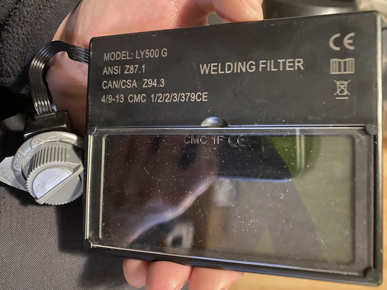

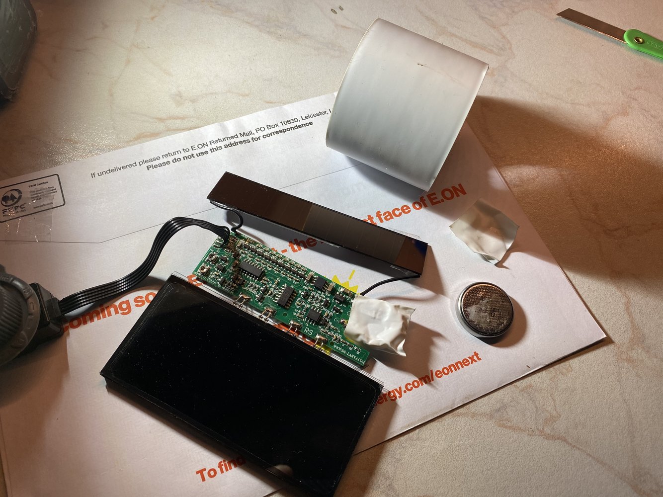

Bought this a few years ago as a back up, tested on a few test welds and very impressed for the price I paid (£25 at the time I think), then simply put it back in the box for storage.
Now last week I needed a replacement lid and wanted to use it, take it out the box and it does not darken at all, tried adjustment & putting it under the strong LED light etc and it made zero difference.
The lens/filter seems like a sealed unit - is it serviceable? is there a battery inside?
