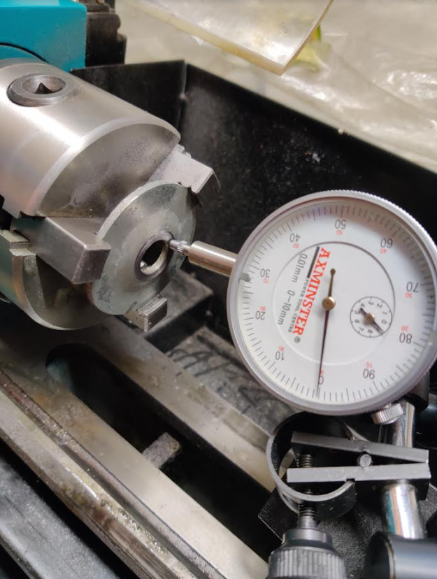

So the first step i made this side as flat as i could at first on my make do surface plate glass and sand paper however i quickly moved then onto the lathe with use of a dial indicator and was much faster and more confident in the flatness of the surface coming off the lathe than my bit of glass

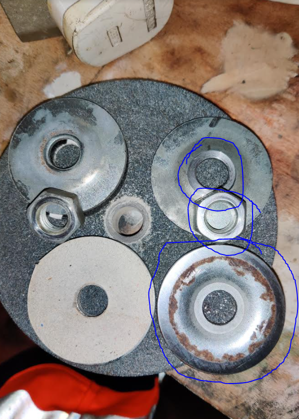

Then it was time to make the other side flat and parallel with bigger stone facing face and that was also done on the lathe , I did not make it too large of a flat face as this is only where a small ridge sits on one side of the stone and the other side the nut is screwed onto this surface

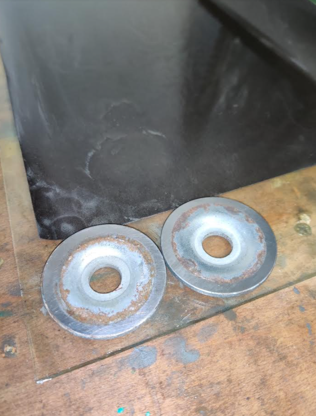

Then i just touched up the face of the nut to make a flatter face , I forgot to take the paper off for this photo , However underneath was just some slighty corroded bumpy pressed steel no machined flat surface to be seen on these

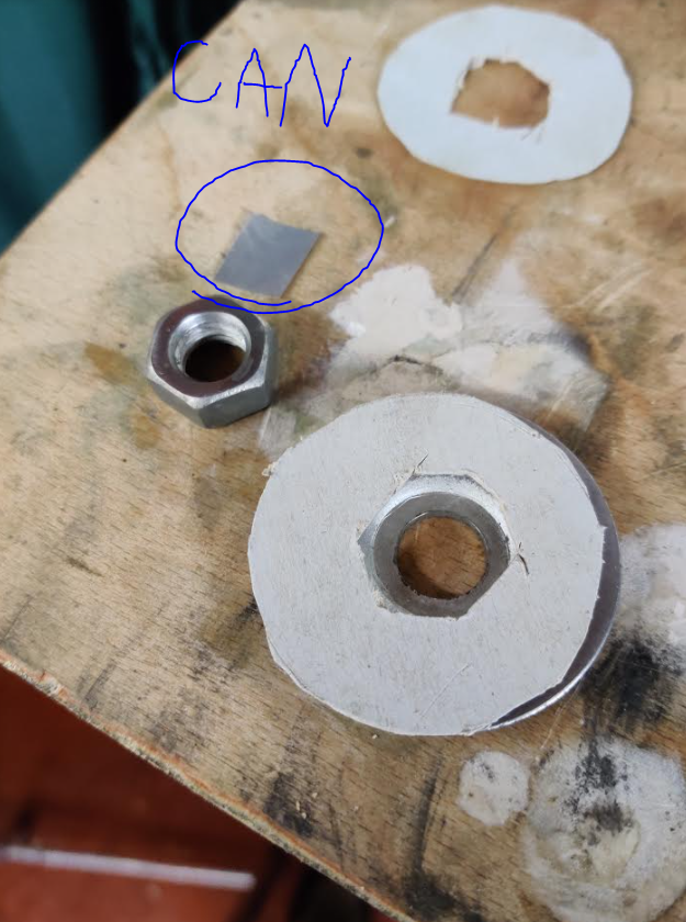

Then some quick washers where made up to go inbetween the stone and , Also see the cut up stella can to be used as a shim later on
Heres the small spacer which i found very trial and error to try and get the machine to run nice

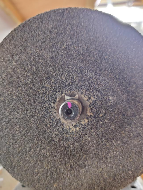

And heres the final result with a spare better condition wheel i found in my drawer - https://streamable.com/upwp0l
