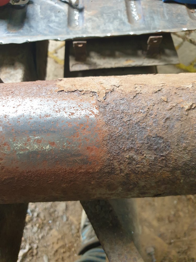

That was done with a 60grit flap wheelThat is polished rust. Apply rust proofer if you don't believe me, and watch it turn blue. Sanding through rust is hard work.
I did it with a 60grit flap wheel, im going to try with my die grinder 90 and grinder.What kit have you available?

I assume you used a rotary wire brush to clean the rust off but as said that is polishing the surface but it will take some of it off so well worth doing.
Take as much of the rust off with wire brushes, needle gun, grinder with flap discs etc. then sand with coarse paper to provide a key.

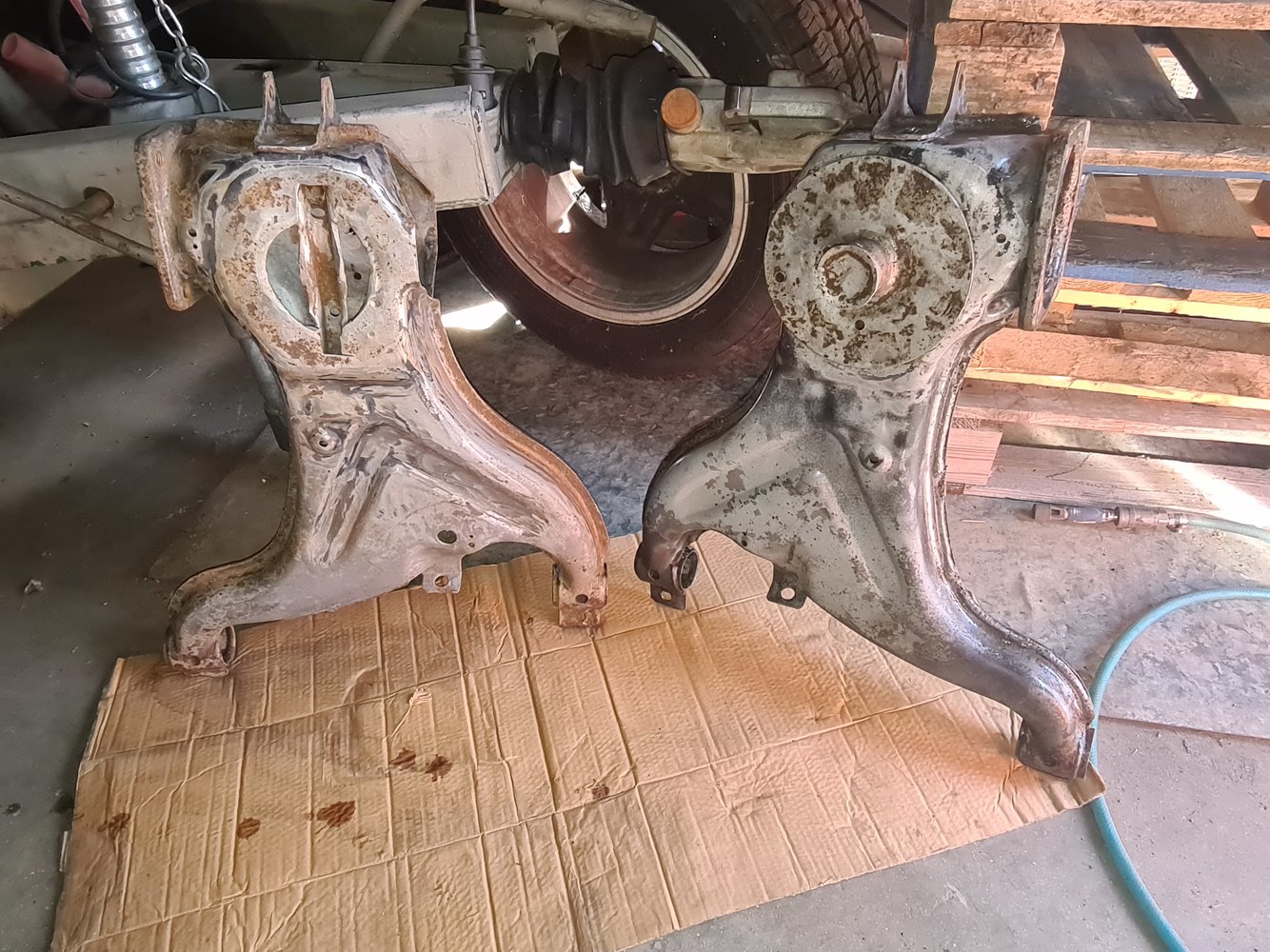

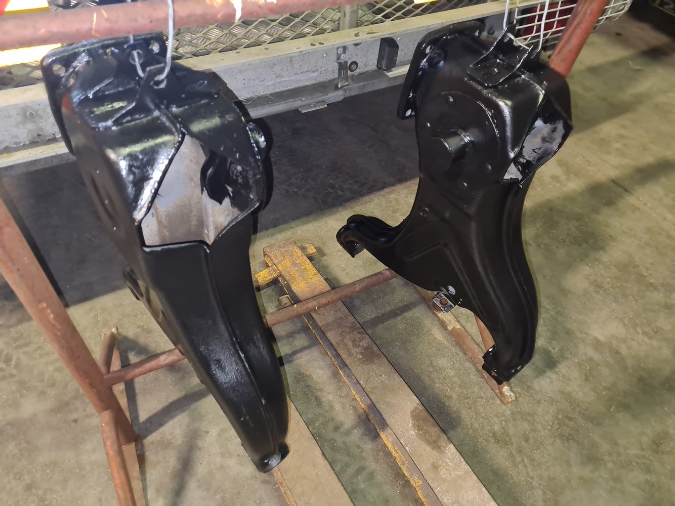

Trailing arms cleaned with a mix of abrasive wire brush, citric acid and media blasting then brush painted. Questions are:
1. The paint is really thick out of the tin, mixed1:4 with hardener its more gloopy than runny. Is this normal?
2. If I thin it using the Jotun thinner then when it dries, it dries mat, ie. looses the gloss finish. Is this normal? @Dcal I know you have said you thin it a fair bit to spray - does it still give you a gloss finish? (the finish in the pics is the 2nd coat which I didn't thin)
3. I put on two coats within 24 hours and have left to dry for a week. I am finding it is really easy to scratch the paint, it isn't "soft" but it almost feels soft, as soon as anything scratches it or knocks it the paint damages or chips. I have used Lechler before and it has gone off much much harder.
I'm not worried about the finish so am not sanding or buffing or anything just wanted a hard finish for underneath the van. A couple of pics just to show what I am doing

Thanks all, gave both tins a pretty good stir then mixed in a pot and stirred thoroughly so reckon it should be mixed ok. Also was using proper graduated paint mixing pots that I had from when I was spraying so ratios should be ok
Didn't realise it would be mat finish so that's cool, don't really mind for chassis components anyway.
Surface prep was pretty good, no loose rust or anything and I would have thought the media blasting would have given a pretty good key. This is what it looked like before painting - different shades are just the lighting when I took the pics.
It maybe that it went on too thick and so is prone to chipping...... next time I will try thinning it a bit as per Dcal suggestion and see how it goes.
