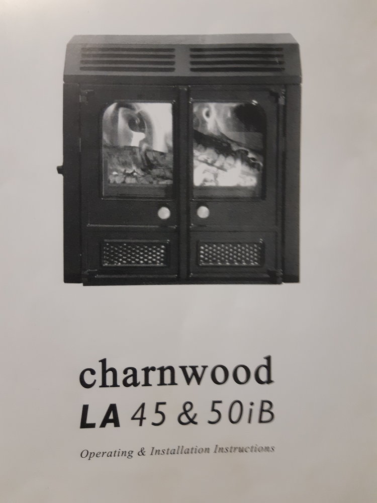

Same as the one my mum has...Left door has a raised profile which the other door has a corresponding groove to go over, if I recall correctly. Can't recall if that bit is rope sealed or not though.
1st thing i checked... only just been let loose on it.. aint been right for a while, bit you know what mums are likeCheck the air control flap doesn't have a piece of coal/coke lodged in it. It's right at the bottom, where the ash pan sits, so it's easy for something to get in there & wedge it open.
@Keith 66
Has yours got 2 doors?
If so assume that one has a groove, and the other a matching v that engages as they shut?
If so has it got a rope seal in the groove like the rest of the door edges?
