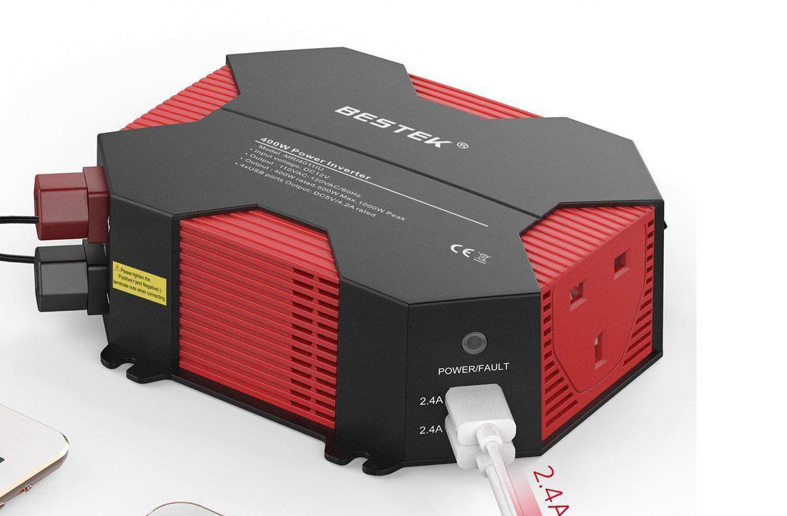

https://www.ebay.co.uk/itm/BESTEK-4...157526&hash=item25d3512cbb:g:PUgAAOSw~T9aWdV4Got a link for that mate.

im in the same situation as you, my biggest battery is 5ah at the minute and the grinder goes though them fast, I currently have about 6 batteries and I drain them all using either sds, die grinder, angle grinder, impact driver etc. 2 rapid chargers and a bestek 400w inverter would cost the same as 1 12v charger and will charge them much faster, im not sure if it means I will need a second 12v battery and split charge yet because that will start to bump the price up a further £150 at least id say, I will see how I gt on just charging them with the van running, if I find I need to charge them with the van stationary then il go down the route of a second 12v battery.

You will need one hell of an inverter to run a welder, you might be better off with a genset welder and use it as a generator to charge tool batteries if you need to chuck them all on at once.
quite complicated when you get into battery run times but if I worked it our right 2 rapid chargers totalling 310w to run on a 100ah leisure battery means I would get 1.85hours of run time before the 12v battery no longer has enough power in it.

I have fitted a fair few inverters into work trucks for people and the main problem I have found is most inverters have a low voltage cutout to make sure you can still start the van again.
This means they will switch off at about 10.5v so if you do fit a second isolated battery you can still only use the top 10% of the power in it. (Or 10ah from your 100ah battery)

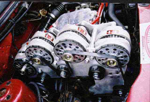

Biggest system I fitted was 3x leisure battries with split charge, bigger alternator etc.
The guy wanted to run a 4" belt linisher 1/3hp or so.
It ran for maybe 4-5mins before the battery alarm kicked in and shut it all down and that was on brand new batteries.
The inverter was a demo thing from a Ring rep who was trying to get stuff into our market so they took it back and adjusted the cutoff down but the overheat alarm would then kick in before the linisher stopped.
Got it to about 10mins run time in the end but this was halved under load/in use.
