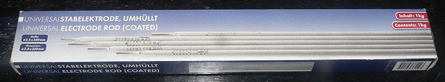

The Lidl box says of the E4322 rods: rutile, cellulose coated for welding low-alloy steels. For all welding positions - also suitable for top welding. Smooth arc welding and good ignition features. Compatible with light socket transformers.
