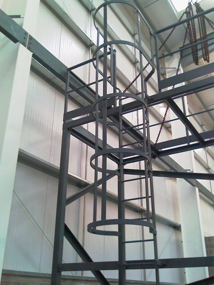

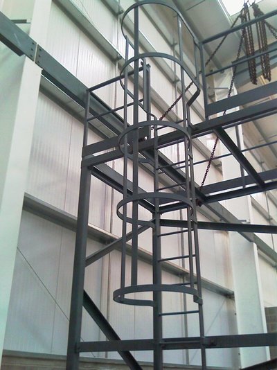

Three days on site this week, installing some channels for pipework support arms to fix to, and a support frame for a chiller unit to sit on.
I did the support frame, minus the ladder, but installed it all.
Put the channels up yesterday. 7 in total. 5.5m off the ground.
(The ones half way up the legs)

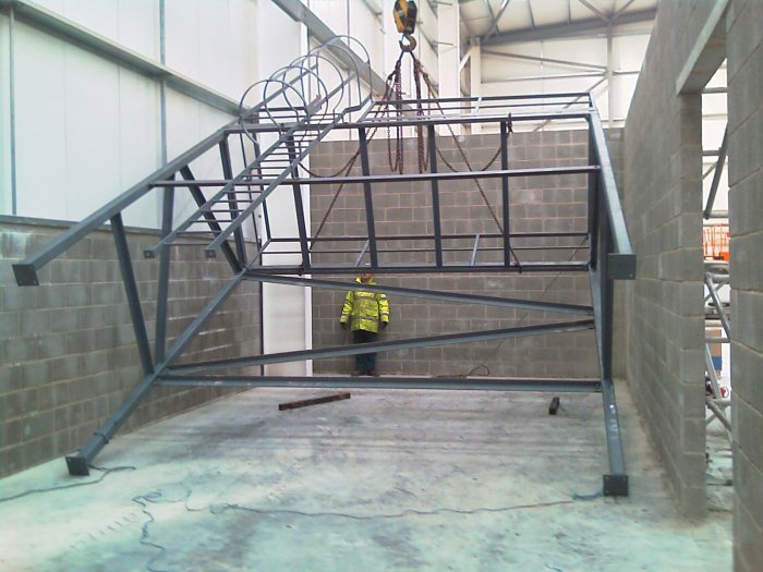

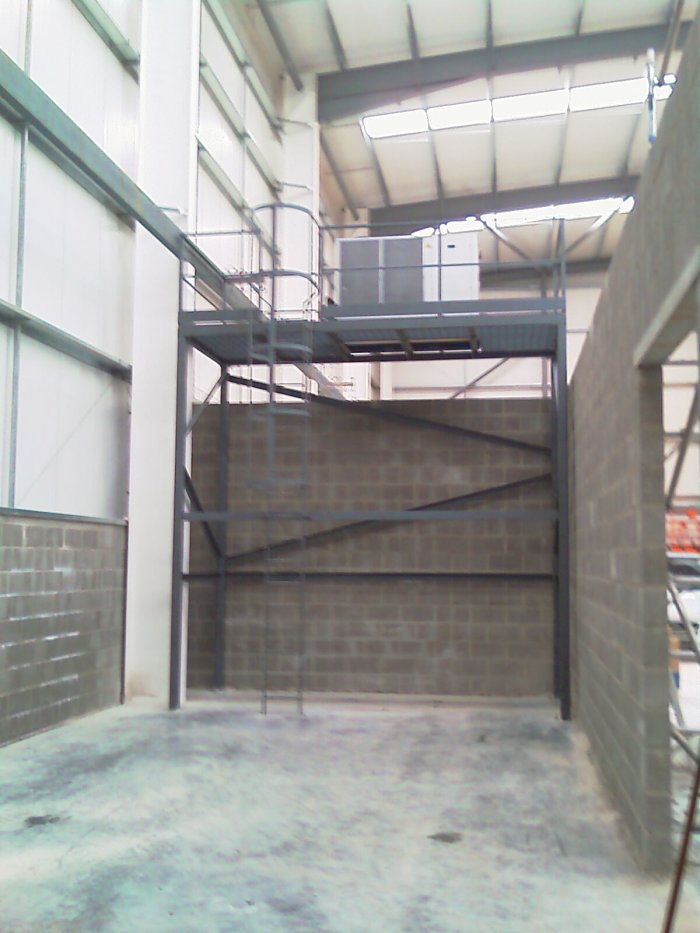

And the frame today. Bit of a squeeze.

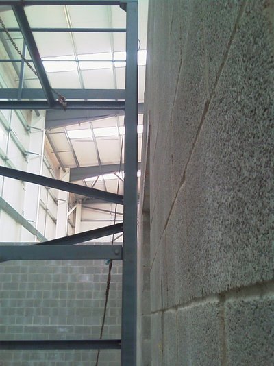

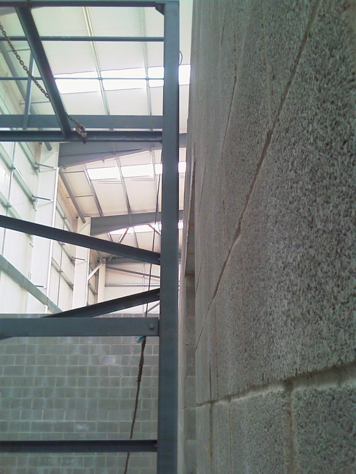

Built layed down in the main building, then lifted into the plant room on its back, then stood up. About 100mm to play with. Didnt really want to knock the single skin block wall down
