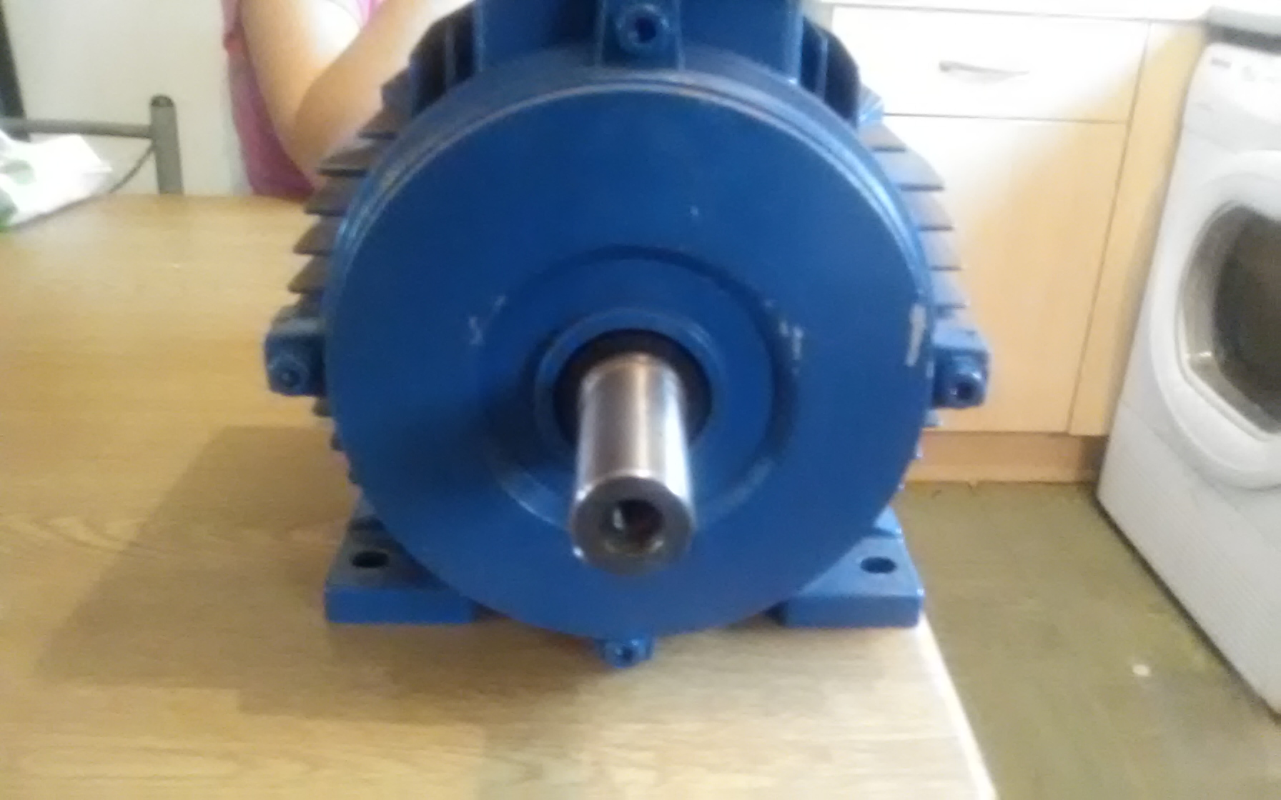

I have unscrewed the flange off the motor be am wanting to change it for a b5 flange but I can slide the old flange off so far but it seems to pull alsorts with it. I can't seem to get it off the bearing on the shaft this is the flange I am trying to remove.
IIRC the bearing stays behind in the end plate and you may have to drift it to the rear to remove it.
