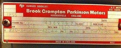

set the links for 240v and as said just change any 2 of the supply wires around and it will reverse providing its run of a 3phase inverter or converter not just off a 240v supplyI presume the motor can be rewired for 240v, but can it also be wired for the desired rotation.
giz the motor if your not using itThanks a lot guys, I will pass on this one.. Much appreciated.
