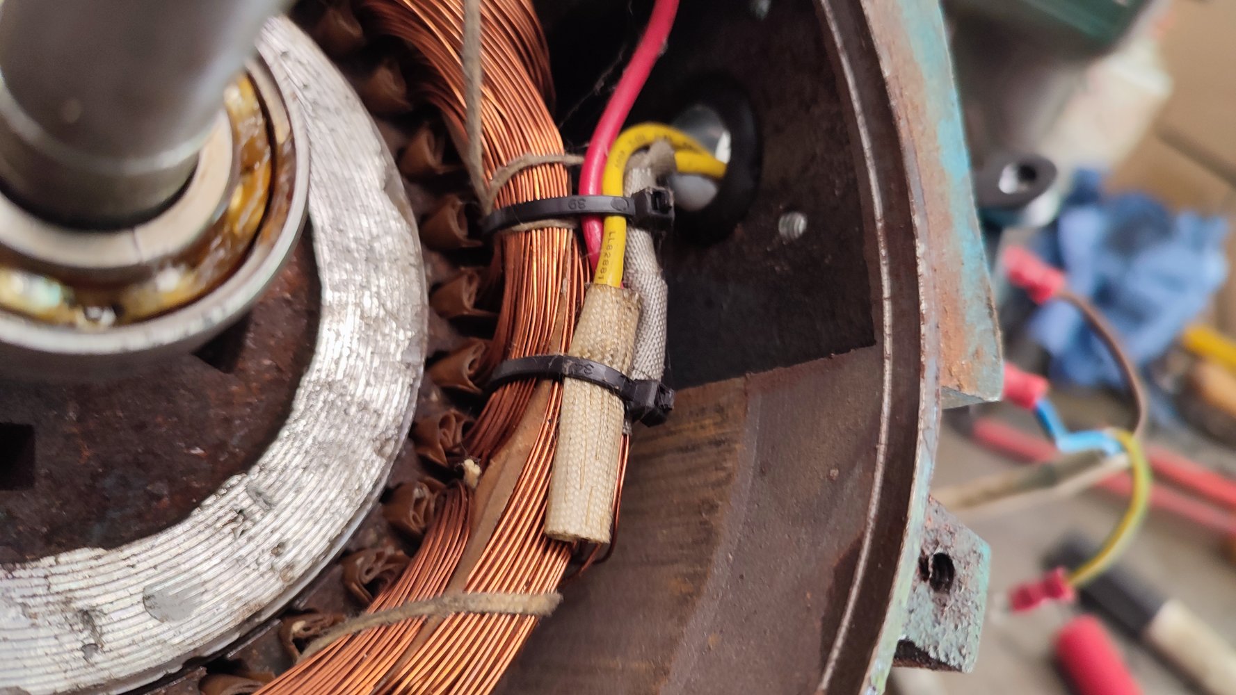

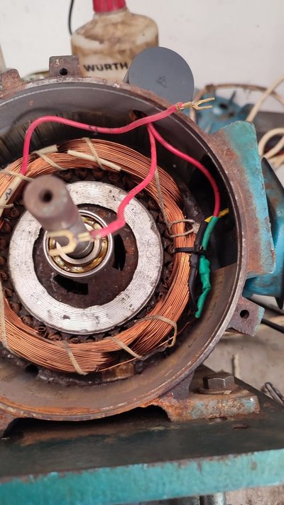

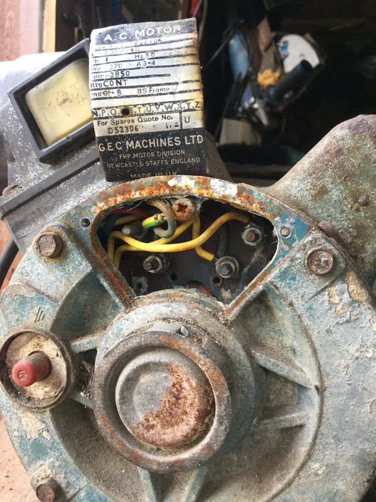

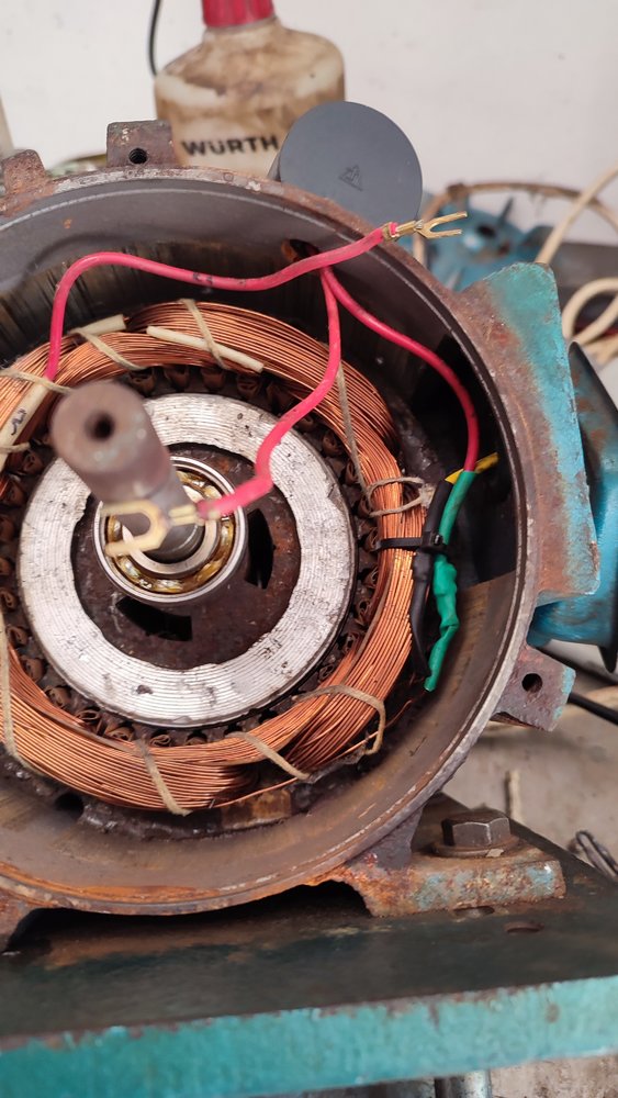

I islandjj Member Messages 134 Sep 26, 2022 #1 Hi , I wish to use another motor on my lathe. I would need toChange the ac motor rotation direction. Is it possible on this motor see photo

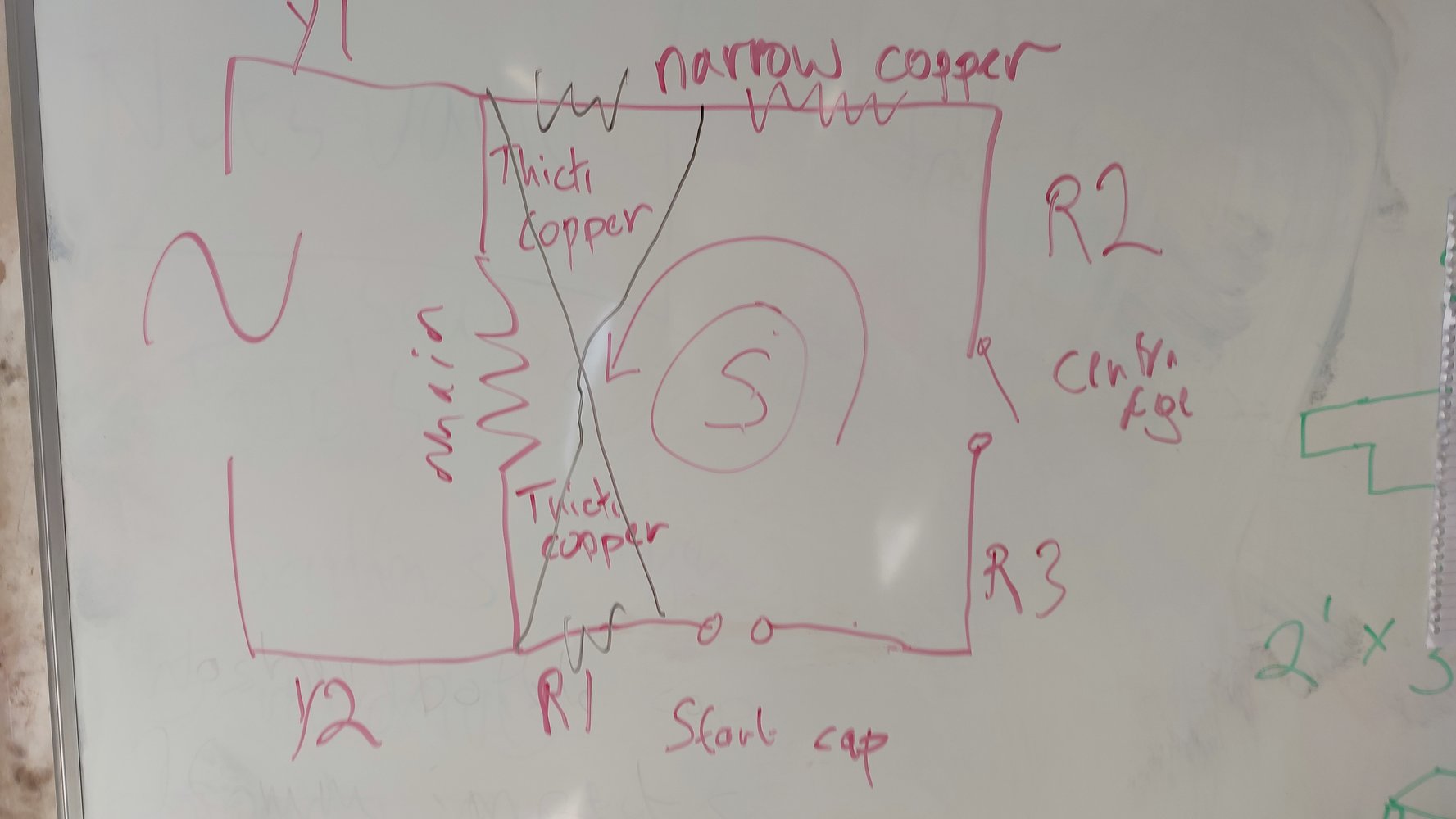

W Wildefalcon Member Messages 2,585 Location Gloucestershire, England Sep 26, 2022 #2 Yes, probably. Did this on Saturday. You need to swap the primary windings OR the secondary windings. Not both.
W Wildefalcon Member Messages 2,585 Location Gloucestershire, England Sep 26, 2022 #3 - ECN Electrical Forums Schematics For: 1 Phase Split Phase Motors - Series 1 These schematics are of Split Phase Resistance Start Motors. *** Part 1: Resistance Start Induction Motors- Single Winding *** Fig. 1.1: Resistance Start Induction Motor Circuit Diagram-C.C.W Rotation (normal rotation) "... www.electrical-contractor.net
