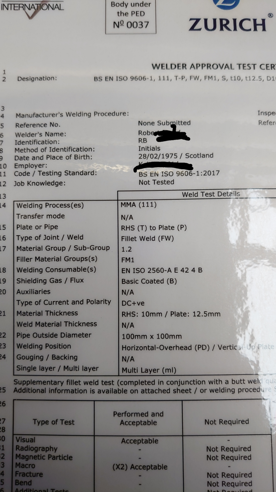

So yesterday I got the man in to put us through our codes again . I had the lad practicing for at his overhead and vertical mig and stick. Usual two bits of 10mm plate tacked at the back in the vice , fillet weld blah blah easy peasy . In comes the man clutching test pieces...not plate , 100mm box ,10mm wall 75mm long and 10 mm plate .
Tack box to plate , put it in vice and weld around it , this means you now do your overhead , vertical and downhand all in one go . So a warning to those coming up for renewal ...it's changed . I think for the better , I preferred it to needing to do separate tests , it lasts for 3 years now as an added bonus .
