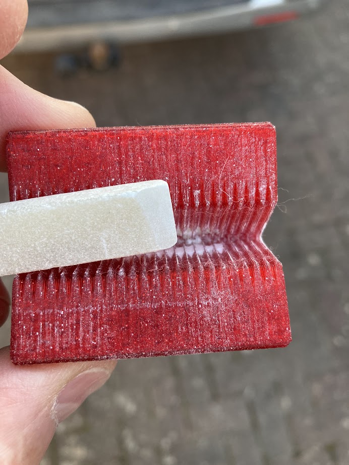

I "discovered" this item whilst searching for something else (sound familiar?). It was designed to sharpen tailor's chalk but it appears to work fine on French chalk sticks that many use for marking metal.
https://www.thingiverse.com/thing:1406527 Printed on it's end at 0.2mm layer height it gives nice sharp edges.
