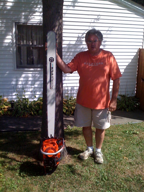

Check for spark first. Pull the plug and leave it on the wire and have a buddy pull the rope. You can lay the plug on the edge of the head and it should spark when pulling the rope. Its easier with 2 people. If spark check out the fuel line it could be rotted off or sucked shut for the new gas formulas. The carb could be dirty as Shenion said, they get shellac in them and gum everything up. I have a lot of 30-40 year old saws i run...Bob
thats one hell of a bar on that
