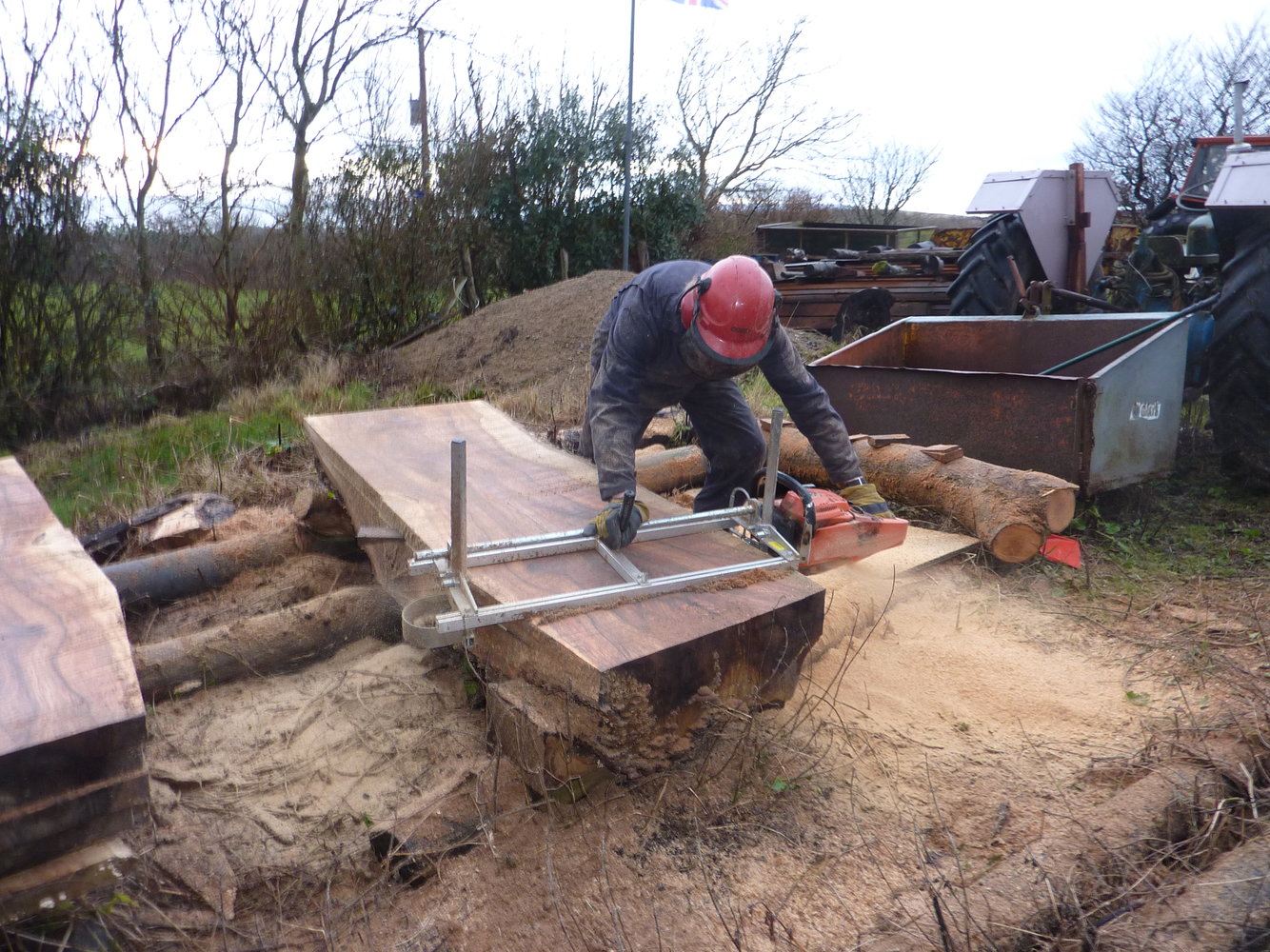

Alaskan mill with beefy saw - I use a Husqvarner 2100 with ripping chain. Uses a lot of fuel, is slow heavy work, and turns a lot of good timber into a pile of sawdust! When cutting some wide european larch 20ft long, it was using a tankful of fuel per slab.....
Here its cutting some old wide ash planks.

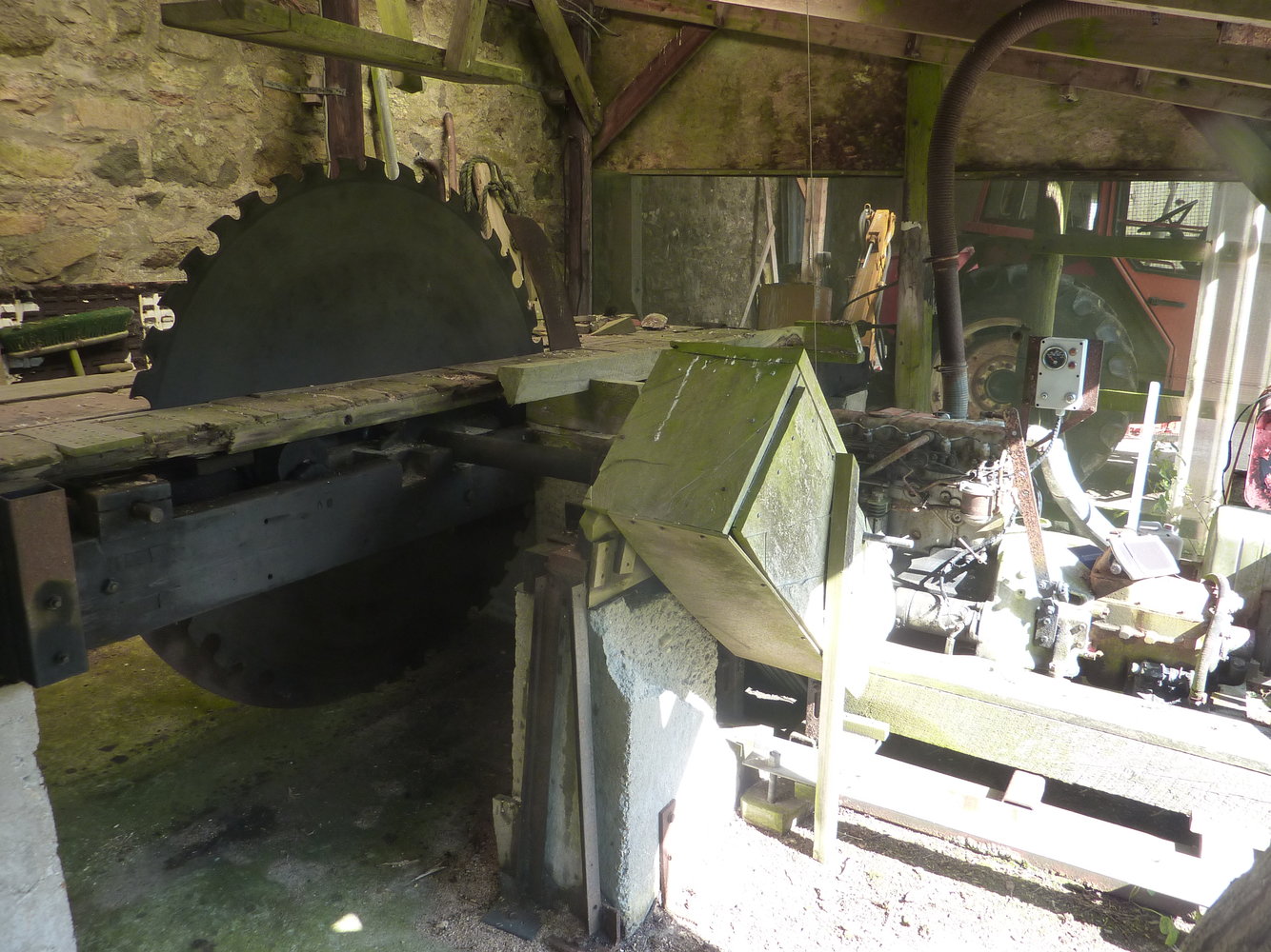

Or you could use one of these - 5ft dia yankee insert tooth blade driven by ancient Perkins 6354 ex tipper truck engine.
Its surprising how good the finish and accuracy can be from a chainsaw mill. A friend used to use one of these Logosol mills to cut Forestry Commission trees with impressive resultsThat's a very nice looking cut you have there. Impressive.
