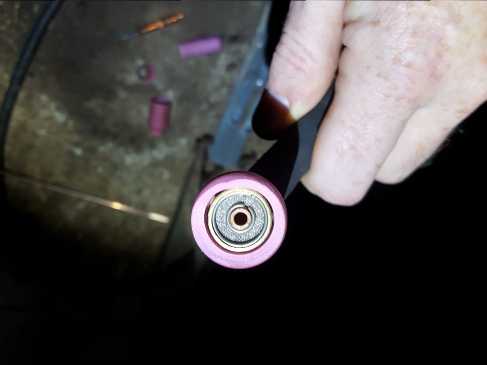

Any brand?

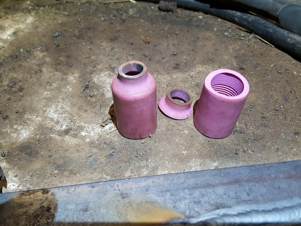

Ahh could be onto something thereI broke one screwing it on too tight ! check inside as you tighten it on , have you got the right white teflon spacer on your torch ?
Just went to check...I broke one screwing it on too tight ! check inside as you tighten it on , have you got the right white teflon spacer on your torch ?
There you have it see , im not just a pretty face you know !
I've got 1 there and thought it was only just enoughHave you got the wee white doodad at the back
Picture paints a thousand words, thanks Paul.How to assemble a gas lens, posted the last time it came up
http://www.mig-welding.co.uk/forum/threads/think-i-have-the-wrong-torch-insulator.52664/#post-610269
