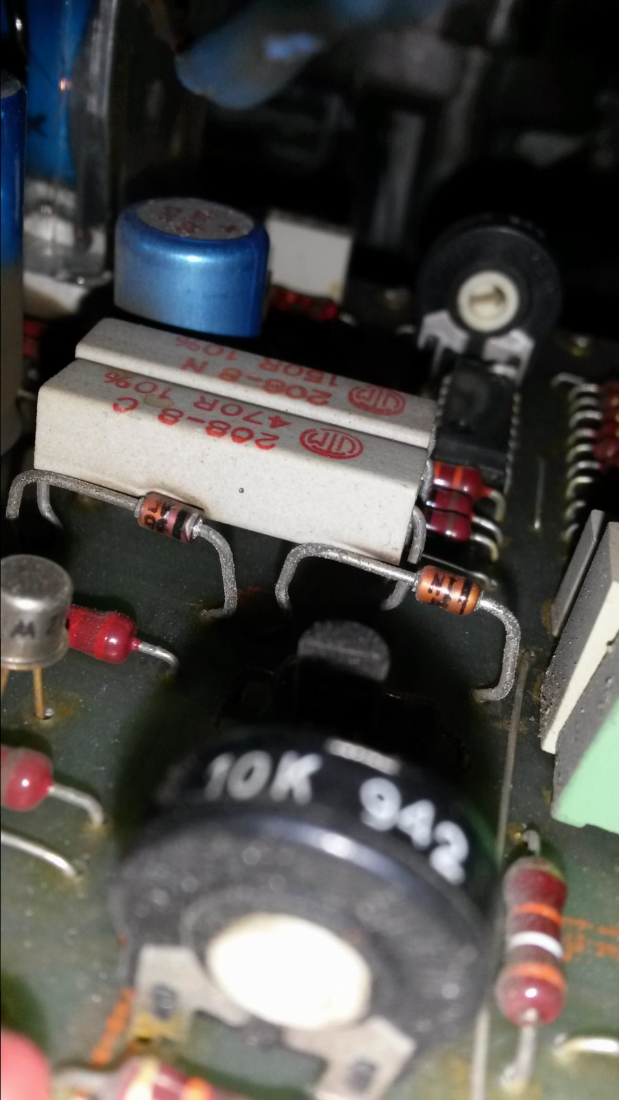

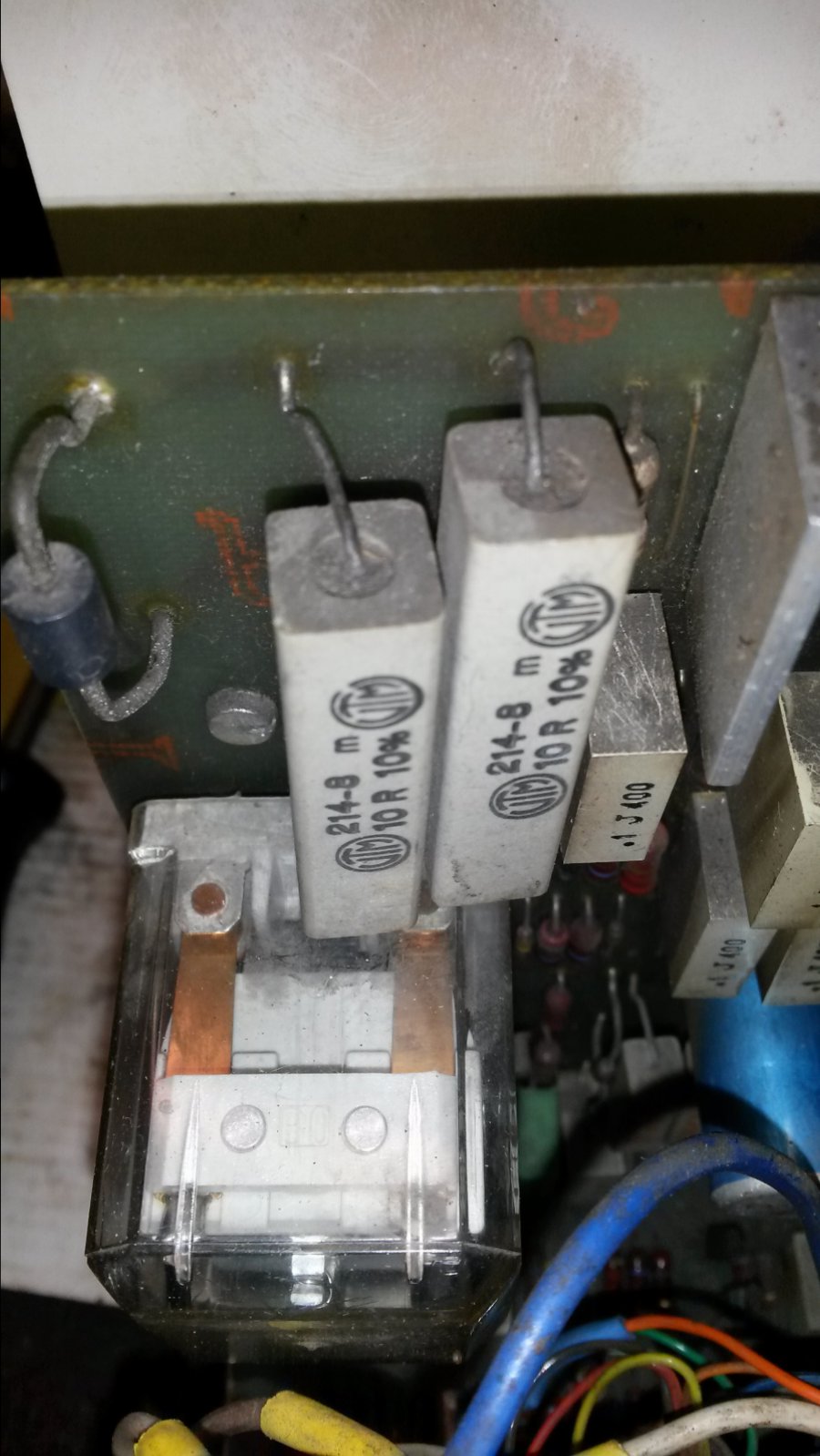

That's how most manufacturers do it, wire one side of the cap rail to the resistor, through the spare NC contact then wire back to the opposite side of the cap rail.
good info Jim, that takes me back to this particular device having a burned contact on that relay.. worth a look I'd say
