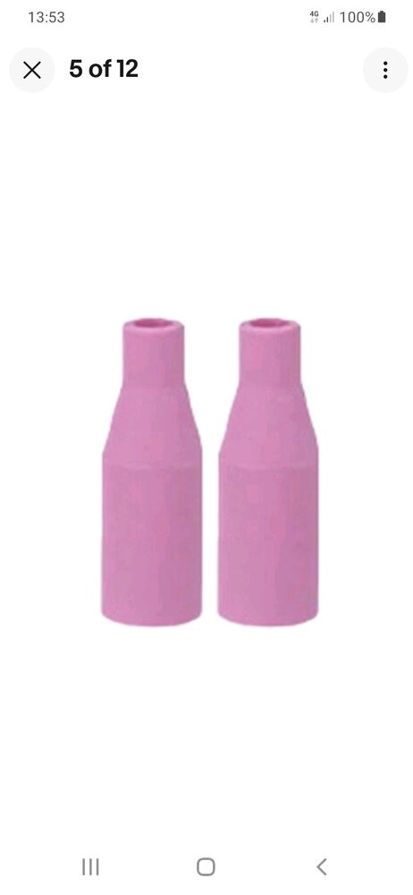

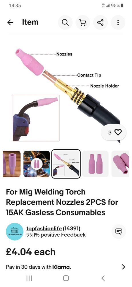

I bought 2 ceramic nozzles from eBay, to try on on my Impax IM-MIG 120A welder.
They are slightly shorter in length than the usual metal conical nozzle, so are handy for using with flux cored wire, as the weld pool isn't as hidden.
The experience I have with them is the following... They clog up quicker with spatter, which also seems to stick more, as it's unglazed. I'm sure this may be sorted with some tip dip.
Any one else had experience of them?
