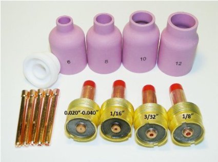

I think they're sixteenths of an inch, else the No.12 in the picture would be 1-1/2".Shroud numbers are a multiple of 1/8"
Speak to Jim or Tom.Make sure that you buy quality Gas Lenses as the cheap items often have inferior gauze fitted which will cause you all sorts of problemsWhat are the numbers on the side of the ceramic. Also iv been using a ceramic 8 but when iv looked for spares and there is different. Also where would everyone else get there's from as looking for all the bits.
After this sort of thing.
