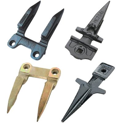

having lost my old trusty centre punch on saturday i had to make one nd im sure all the farmers know this trick for a centre punch chipping hammer or stone chisel, the old tynes off the haybob make great punches, cut off 5" of the straight of the tyne point it weld 1/2" nut on the other end, if you have a haybob tyne make one and let me know what ya think.
