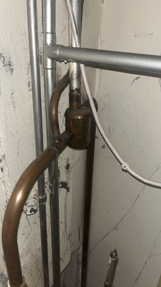

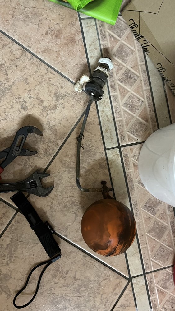

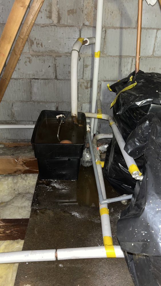

one other thing if some idiot without knowing there system that they have
has fitted all rads with trv vales it will cause the water to auto pump direct into the tank as its got no where to go but through that overflow pipe
when the rads temp hits there set they shut down leaving the pumped water no where to go as normally they can use the bathroom rad and return back to the boiler therefore shutting the boiler down
