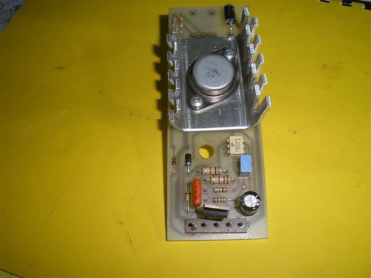

I have an older HF CEMIG160T which up until the other day has been working like a champ. Oh, it has it's idiosyncrasies but on the whole does what I need around the place.
The other day when I turned it on it started buzzing like crazy. I looked inside and saw the relay (contactor) contacts vibrating. I disconnected it but the buzzing continued. I tracked the buzzing to the gas valve. I pulled the coil off it and using another 24v transformer (actually a door bell transformer) I checked the coil and it was operating just fine. I checked the output voltage on the 220VAC to 24vac transformer on the bottom of the welder and it was ouputting 27.3 volts which should be about right.

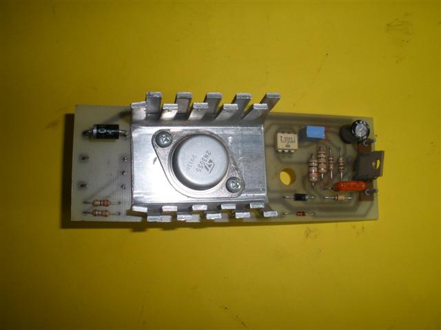

This brought me to the controller board.

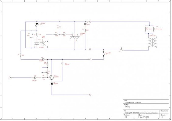

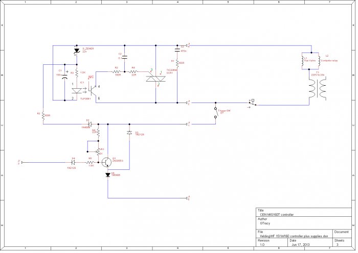

I checked the internet and I don't see a schematic for the one I have. I know this welder was made by CEMONT.
I've attached a couple of pictures of the board in the hopes that someone my have the schematic of this welder and the controller board.
One final item is I am still puzzled what might be causing my problem, so any ideas would certainly be appreciated.
