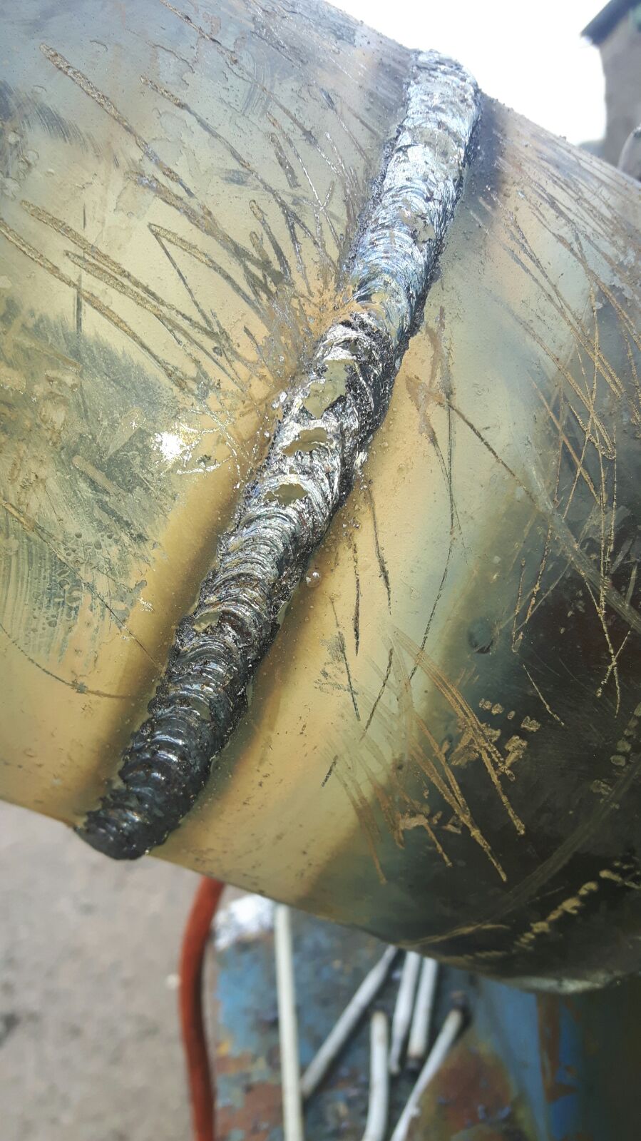

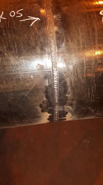

here are some pictures of the dark art to guide you,vertical down on12 inch and 8 with 4mm 6010

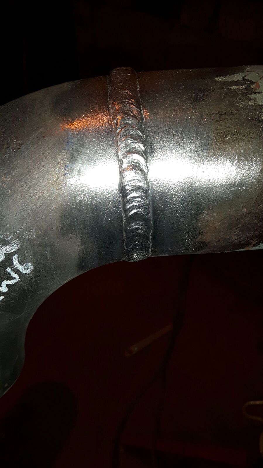

a 24 inch 4mm down and a down hill root a 3 inch rooted uphill with 6011 and down hill cap with 6011 3.25

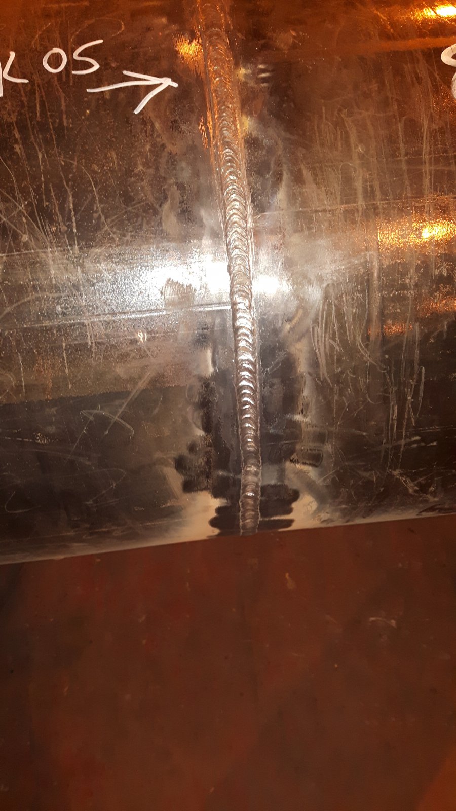

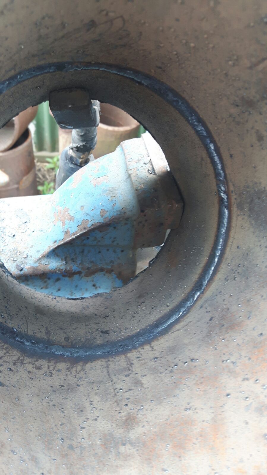

a 6010 root down hill 3.25 and 4 mm cap down

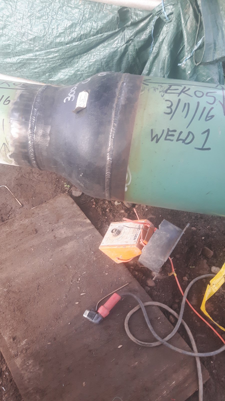

welding machines used were powcon ,and argen ,
