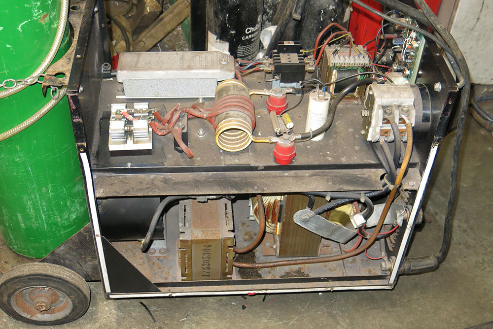

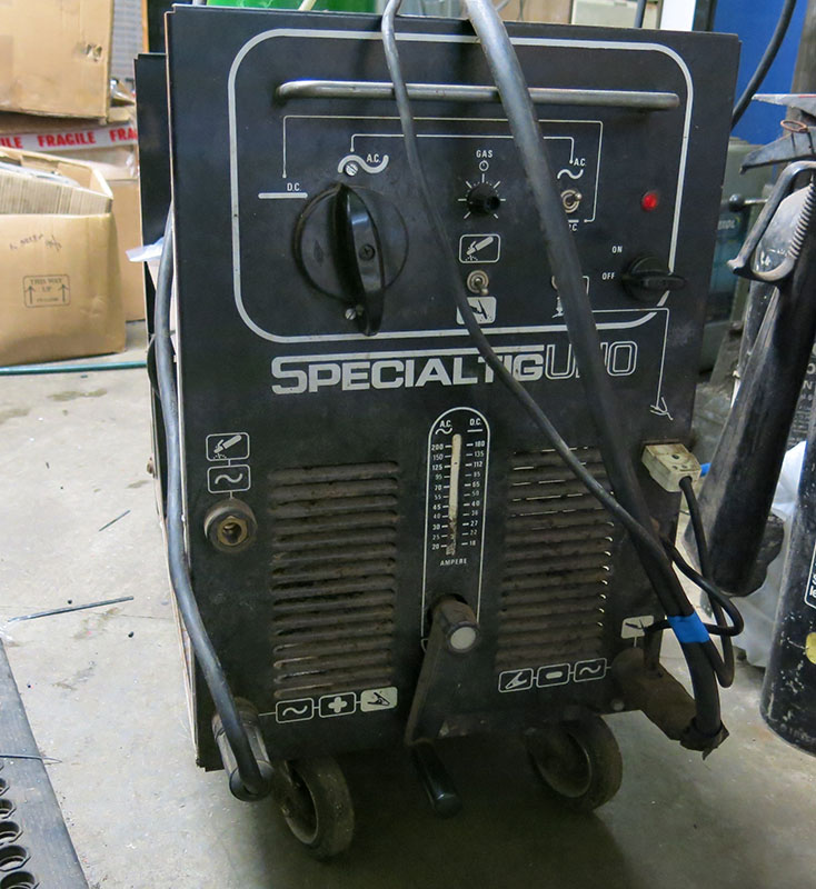

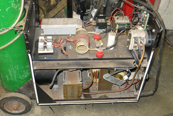

3 phase Cebora Special Tig Uno 200amp (pics below) [edit: should have said 2 phase + neutral]. It's the one with the wind-up handle on the transformer i.e. old school with minimal settings. It's been working fine for approx 20 years but it's suddenly developed a problem in AC mode. It'll strike an arc between the tungsten and workpiece but it's super weak and there's no way it'll even think about melting the aluminium. Everything's working OK in DC mode. I've had a search around the forum and saw mention of cleaning and adjusting the points. They were sparking but I cleaned both pairs and reset them anyway. Still can't weld in AC.
I've seen mention of the capacitor being a possible cause. I've not swapped it for a new one yet. Does the capacitor affect the AC side of things only? I got the local electrician to check capacitance (my cheap meter doesn't have that function). He said it was OK when powered up but empty when the welder is switched off. That's all the info I have at this stage.
Thanks in advance for any advice etc.
