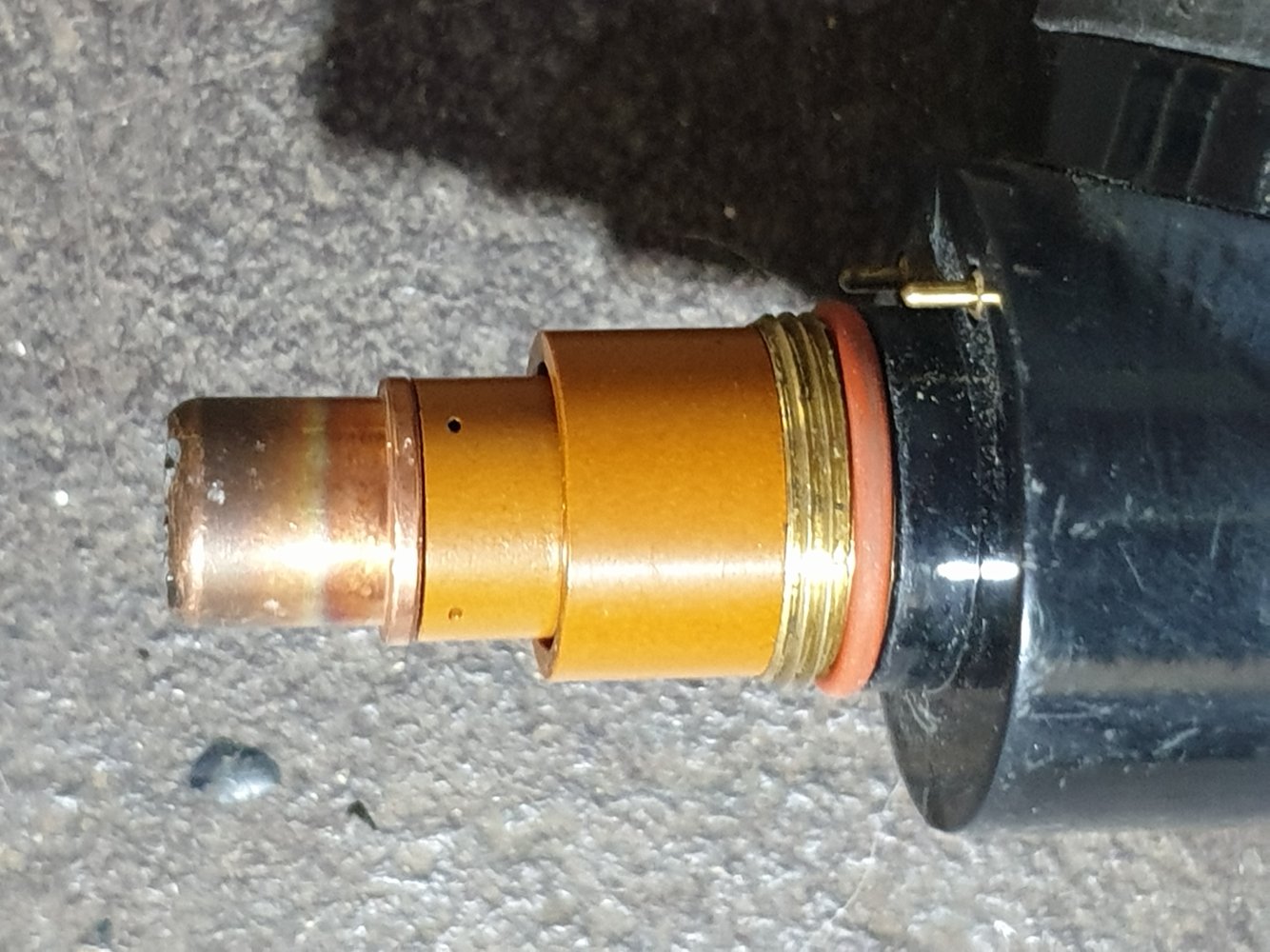

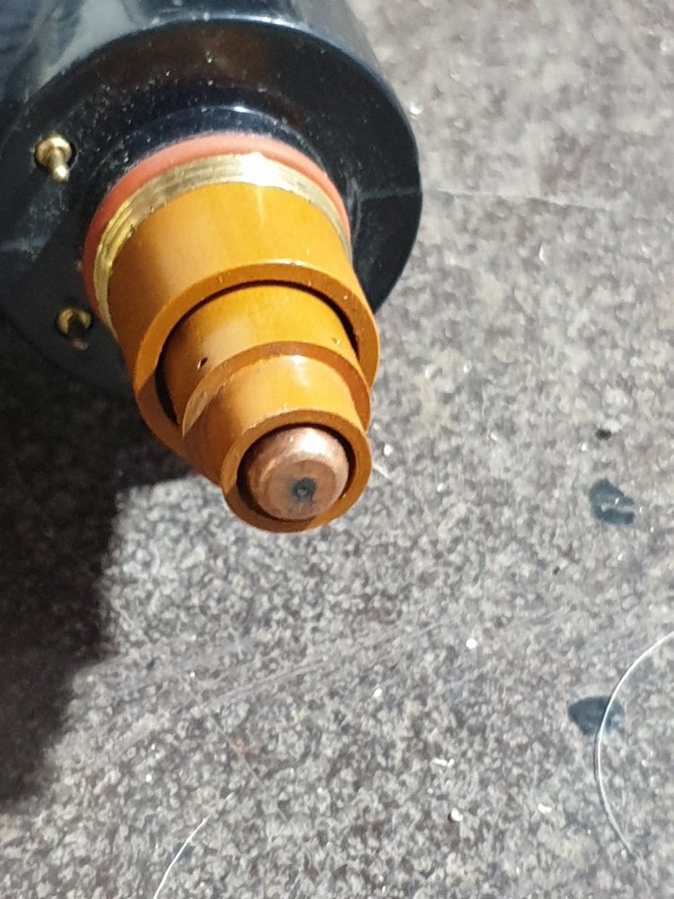

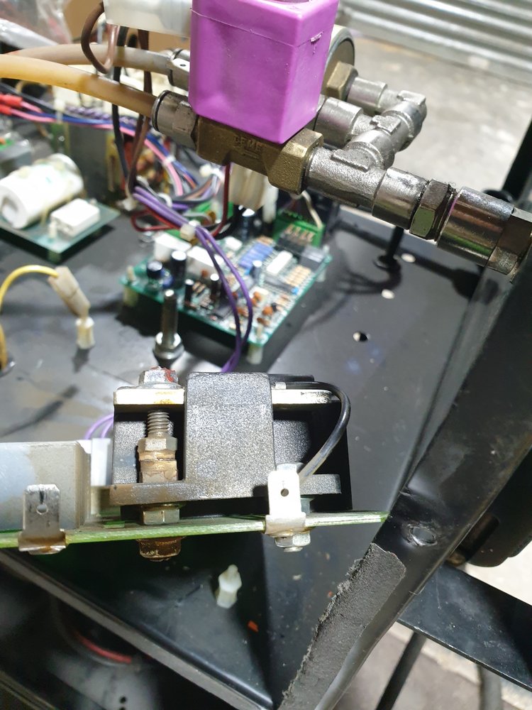

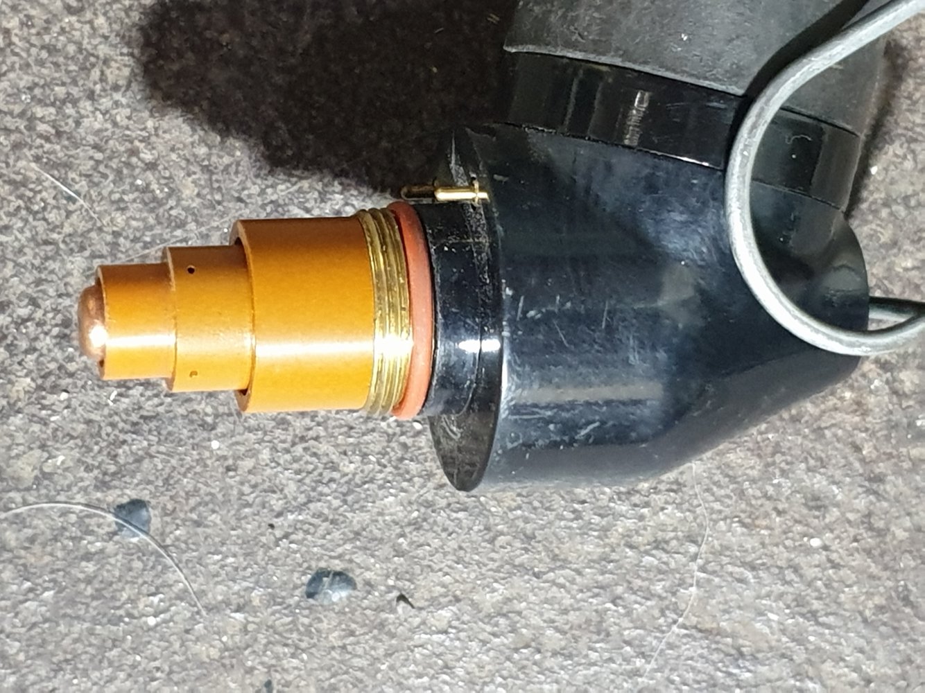

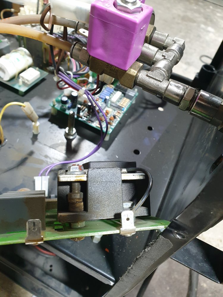

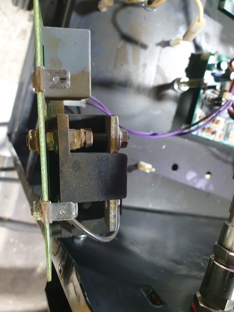

Some of you may link this thread to a For Sale (now Sold) non-working Cebora Plasma Cutter. Access to the inside was relatively straightforward, the transport company had dropped something heavy on the rear corner where the regulator is and pushed it in! I had to take all the covers off and remove the rear panel to straighten it!
This is how far I have got!
I know I have 3 phase at the incoming on/off switch.
There is 3 phase at the transformer.
The rectifier works (about 200v DC?)
There is continuity along the lead to the tip of the torch.
The air pressure is sufficient (I know that as when it was too low I had a red light on the panel and the contactor didn't work, upping the pressure, the red light goes off and the contactor pulls in.)
The push button on the torch handle operates the air (air is present) and the contactor pulls in. This also proves the shield is present as it forms part of the electrical circuit.
With all this - I do not get an arc.
My immediate thought is that there is no HF to start the arc, but I'd appreciate others' opinions. I'm hoping I can look at any HF using a 'scope?
Cheers
Peter
