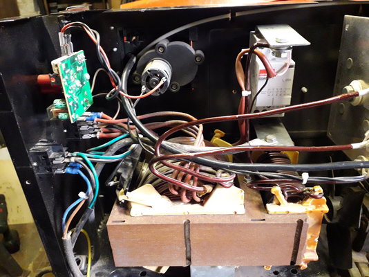

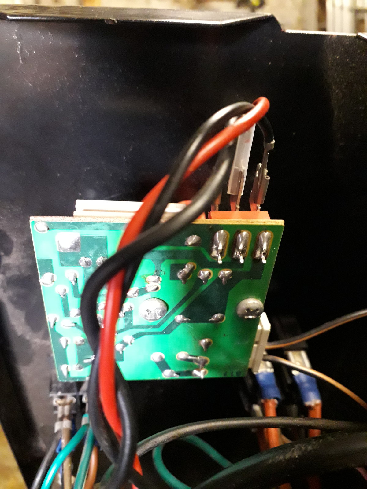

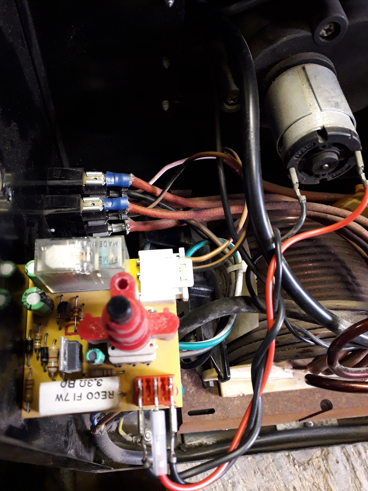

Hi folks. After 30 years of trouble free welding my MIG has finally thrown in the towel! Hopefully someone may be able to give me some pointers. It started with the contactor chattering a bit. On inspection the contacts were badly burned so after studying various threads on this excellent forum I got a new contactor thinking it would solve the problem. It didn't. It turns out I don't have 240V across the two little contactor coil feed wires. Most things seem to check out Ok. The wire feed drive is fine. I get continuity from the machine end of the torch trigger wire to the contact tip when the trigger is pressed. I stripped the brass block in the trigger and cleaned the contacts on the trigger plunger. I've checked all the connections, a number of the spade connectors on the switches were a bit loose so I've replaced these. So far as I can tell, and I'm not a welder engineer, the only thing left to suspect is the PCB. However, the little relay on the PCB seems to click in and out fine when I pull the trigger. But, the new contactor remains dead. I've tested the new contactor off the machine and its fine. I would be really grateful for any ideas on this one. Thanks.
